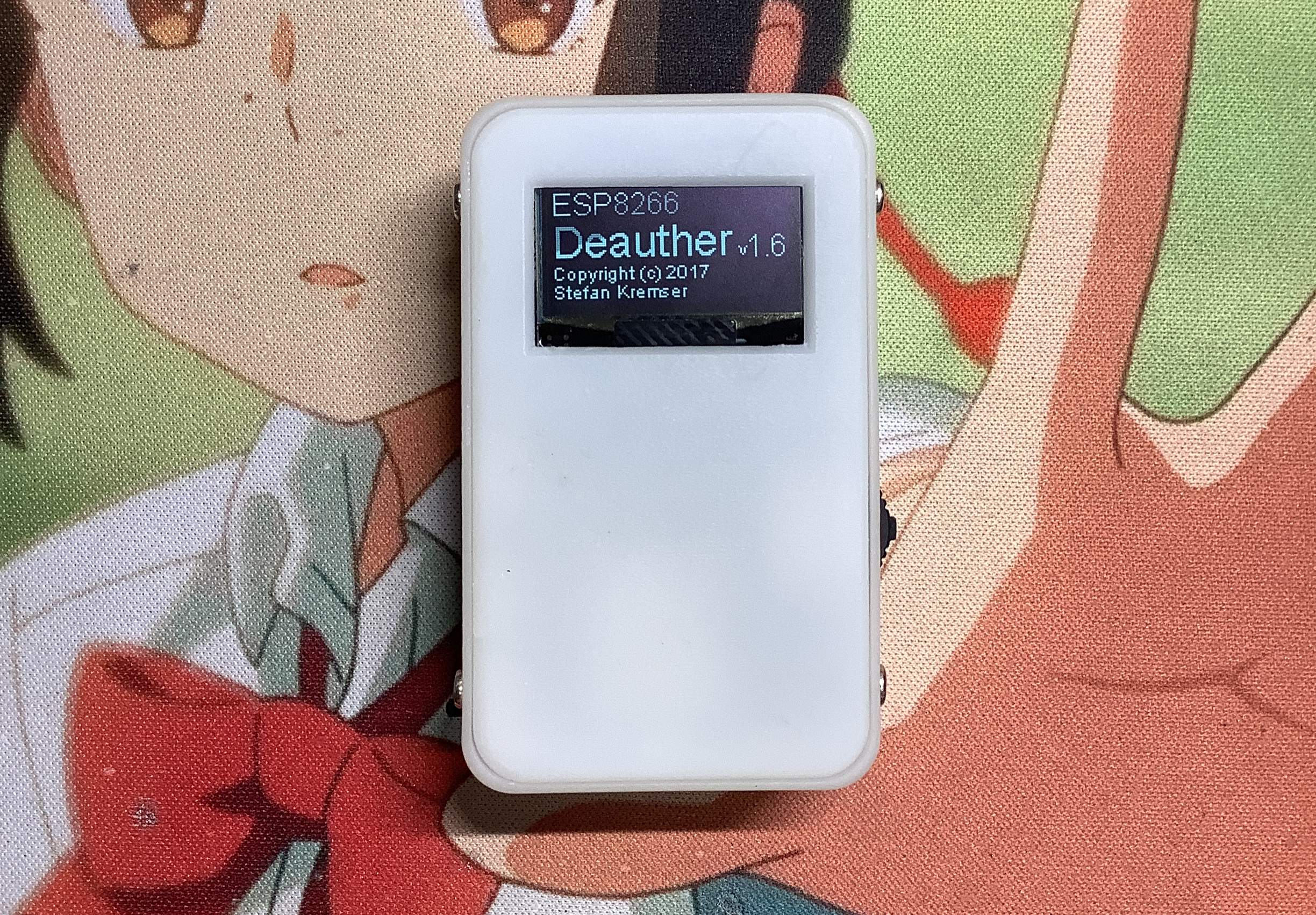

WiFikiller is used to test network security, please do not use it to attack other people's networks!
This machine uses a pulsator switch for up and down and confirmation operations, which is more convenient and space-saving than a key switch. This version is equipped with a 3D shell to improve the appearance and beauty. You need to pay attention when welding, first put the screws under the screen before welding the screen!
The copper pillars are 12mm M3 copper pillars, and the shell screws are M2.
The buttons on the left are the reset and download buttons, and the bottom is the switch.
The battery model is 202540. Considering that it is mainly idle, there is no charging circuit designed.
There is a management backend web, and the WiFi browser connected to the ESP opens 192.168.4.1
Management background: 192.168.4.1
SSID:pwned
password:deauther
