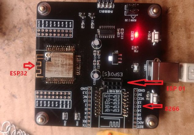

Both burning and testing are possible.
Support automatic download and automatic reset
Automatic burning, after the burning is completed, the hardware will automatically reset and enter the running mode.
ESP8266 burning test
This is 12F automatic burning and automatic reset test.
ESP32 burning test

If you don't buy enough pins, or you only need to program without testing, you only need to deploy a few programming pins.
Because I don’t have enough needles on hand,
I soldered two boards.
One piece, all the 12F pins are soldered, but the ESP32 is not soldered. I bought some pins later to make up for the ESP32.
On the other hand, both 12F and ESP32 only have pins for programming a few necessary pins. (Picture below)
Pins that must be soldered.
vcc, gnd,
en (rst), io 0 , rx ,tx ,
io 15 (only 8266, occasionally burning will fail if not connected)

Unable to burn simultaneously
Although it supports burning multiple boards, one burning board cannot burn multiple boards at the same time.
RX and TX are shared.
And their firmware is also different.
Jumper
In order to isolate the test pins of 8266 and ESP32, io 0 and reset are isolated (you can also not isolate them)
Take the following diagram direction as an example,
The 8266 series (12F/ESP01) on the left, and the ESP32 series on the right.
There are two rows, one is the reset jumper and the other is the io 0 (that is, the boot pin) jumper.
capacitance
The 0603 capacitors above the 1117 are all for the 1117.
There are two capacitors under ch340, which are only used for ch340, so they can be saved.
On the 1117, I have reserved two direct plug-in capacitor positions.
If the voltage of the module is unstable and the serial port is disconnected, add a capacitor.
I added two 100uF direct plug-in capacitors (I omitted all the 10uf capacitors, it is very stable.)
Manual burning
In some special cases, automatic burning will not occur.
For example, the previous code runs out of stack, and the module automatically restarts as soon as it runs, and restarts repeatedly. In this case, there is a high probability that the automatic burning will fail. It must be handled manually.
1. Press and hold the [Burn] button . (Actually, short circuit io 0 and GND)
2. Press the [Reset] button and immediately release the [Reset] button. (Actually, short-circuit en and GND)
3. (After waiting for another 1 second) release the [Burn] button. At this time, the board is in burning mode.
4. Development tools or burning tools perform burning.
5. After burning, you may need to manually press the [Reset] button
