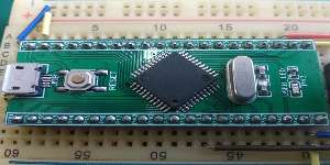

Minimum system board based on STC12C5A60S2 chip
51 development board
  • Based on the STC12C5A60S2 chip, the board integrates the CH330 serial port, crystal oscillator and power-on reset circuit. The size is 30mm wide and 52.3mm long. It can be plugged into the DIP40 chip socket and breadboard.
  • There are two errors in DRC, which are caused by the USB through hole distance from the pad being too small and library problems. There is no solution for the time being, but it does not affect the use. 3D diagramSnipaste_2019-09-02_11-24-16.pngSnipaste_2019-09-02_11-24-45.png
Picture of the blank board after proofing: Picture 1.pngPicture 2.pngPicture after welding: Picture 3.pngPicture 4.pngPlease see the attachment for related instructions, videos and procedures.
