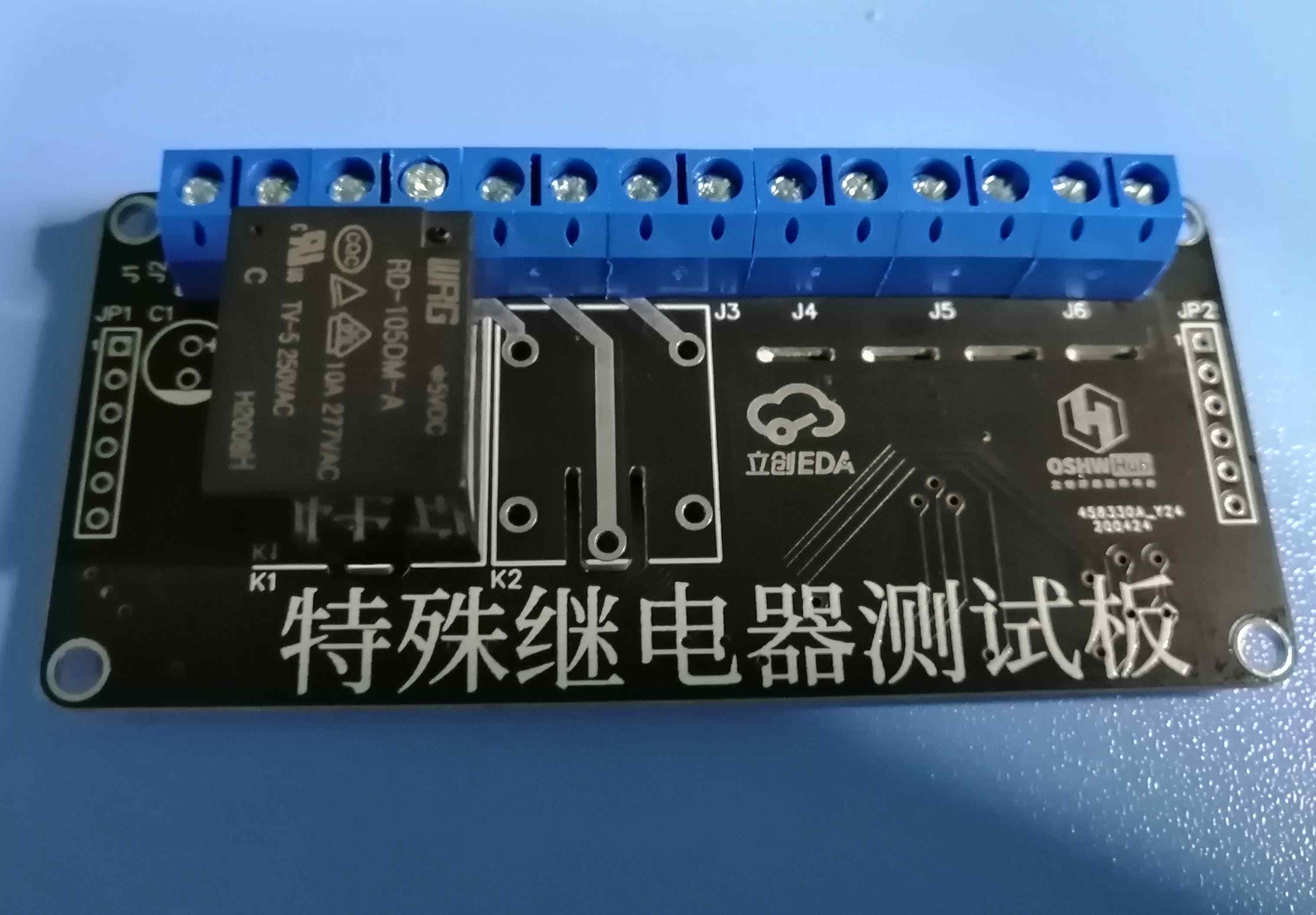

HC595 is used to drive 4 channels of photorelays + 2 channels of magnetic latching relays, which can be expanded in cascade.
But what I want to convey about this PCB is the advantages of other unconventional relays.
Advantages of optical solid state relays compared to ordinary relays:
  1. Not easily affected by vibration,
  2. Switching speed is slightly faster,
  3. No mechanical action, higher reliability,
  4. Smaller package
Advantages of magnetic latching relays compared to ordinary relays:
  1. It relies on magnetic self-locking after one movement, which saves power when the status does not change frequently.
Production process
IMG_20200625_183750.jpg Use the wrong resistor package, regret it. IMG_20200625_184213.jpg Solder the patch IMG_20200625_190620.jpg and plug in the resistor. Then buy the components IMG_20200625_191025.jpg . Front, I forgot to order the magnetic latching relay. The ordinary relay is on top. IMG_20200625_191457.jpg
