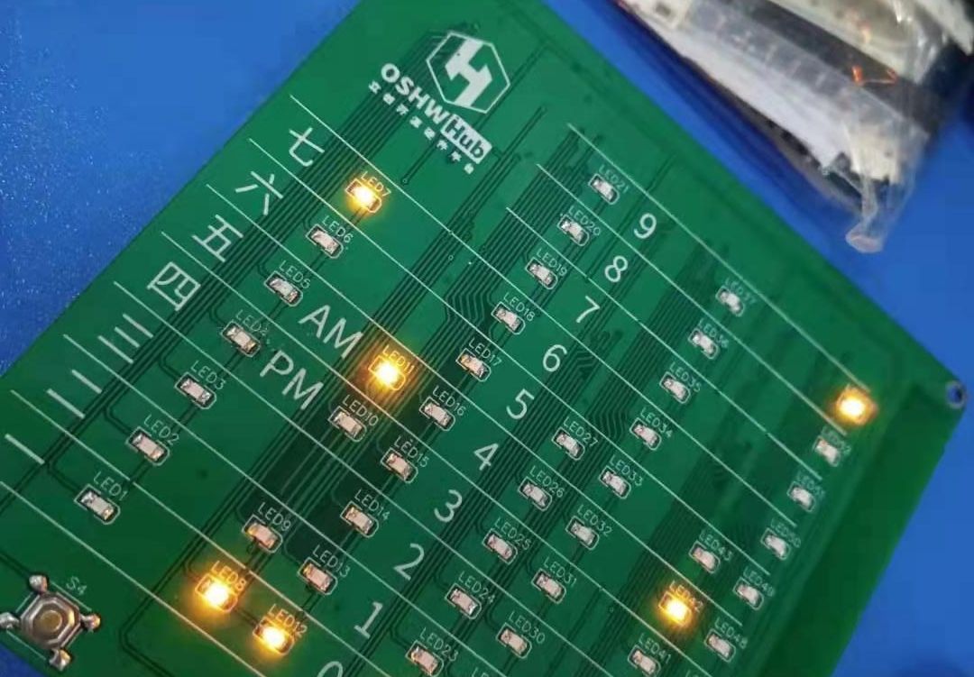

[Digital circuit] CD4017 running water lamp clock
working principle
clock source
The power frequency electromagnetic radiation is collected by the antenna and shaped by NE555 into a 50Hz square wave.
Frequency division
U2 divides 50Hz by 10 to become 5Hz, and then U3 divides 50Hz by 5 to become 1Hz, which is used to provide second travel time later.
Display and hexadecimal
This is a second display circuit, and U4 divides it by 10. And display the ones digit of the second.
U5 divides the frequency by 6 to couple the minutes to the next level.
Hexadecimal and display
U9 divides the hour by two, and is reset by an AND gate composed of D1, D2, and R5.
When 12 o'clock, RST is high, U8 is reset, hour0 outputs high again, hour00 flips again, providing signals for AM and PM later.
Low brightness at night
From 6 am to 6 pm, !Q output is low, and it is full brightness at this time. On the contrary, it is only half the brightness.
In the implementation process, at 6 o'clock, the AND gate is enabled and the status of morning and afternoon is transmitted to the subsequent RS flip-flop to achieve the self-locking function.
Continuous triggering of keys
When the button is pressed, the previous 5Hz will be output to the clock terminal of CD4017 through the button for counting. In order to prevent the two output ports from being short-circuited, a 10k resistor is added to limit the current.
Usage details
Because most schools now replace fluorescent lamps with LEDs and do not have inductive ballasts, the power frequency radiation signal in the training room is relatively weak.
It is possible that 50Hz cannot be received at certain locations and angles. It is recommended to place it near a socket or extend the antenna when using it.
