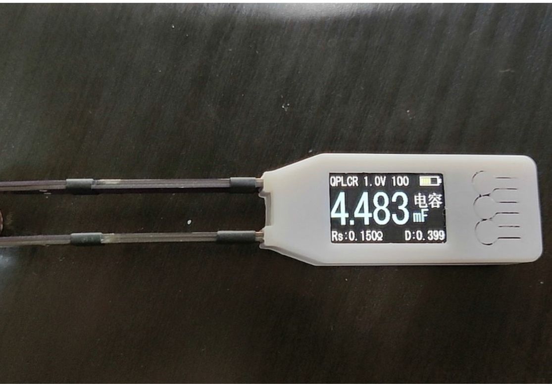

1. Appearance diagram
2. Version differentiation instructions
1.      Agreed name:
First car = first version = 2S version
Second car = second version = 3S version
2. Corresponding version of 2S version PCB :
(All plate thickness 1.0 )
Measuring board 2S        display board 2S      camera leg 2S
3. Corresponding version of 3S version PCB :
Measuring board 3S         display board 3S      stand leg 2S
4.Corresponding      firmware version:
2S:
071Vl.XXX
571Vl.XXX
3S:
071 V2.XXX
