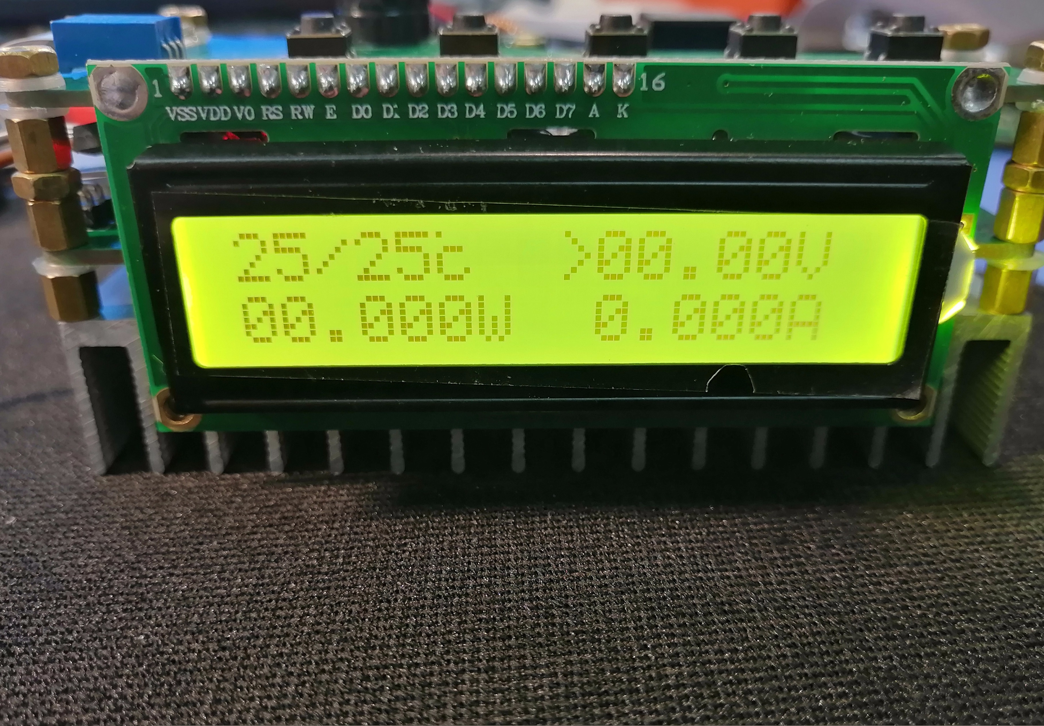

Mechanical Design:
The overall design adopts a motherboard design and is connected through FPC cables, making it easy to adjust the height or plug in and out the STM32 minimum system board.
(The potentiometer with white tape is a sign of calibration)
Finished product pictures:
