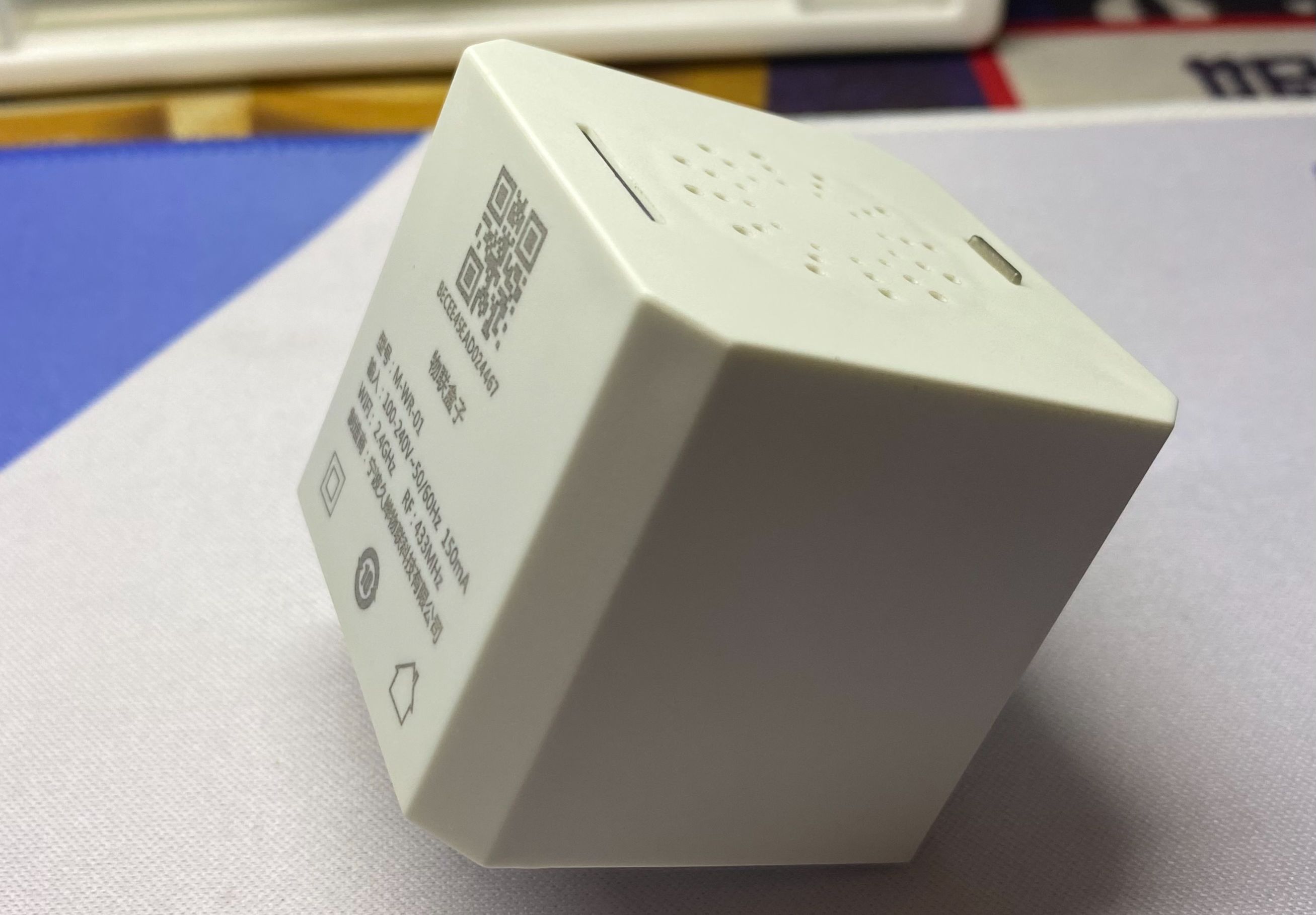

This project uses Tuya’s development-free solution to implement multi-mode gateway design (only Tuya module access is available). The hardware is very simple and only requires one LDO regulated power supply + two modules. Very suitable for smart home scenarios
Engineering features:
1. WiFi+Bluetooth uses the Tuya WBRG1 module, and ZigBee uses the ZS3L module. Both models are free of development.
2. Two status indicators show the working status.
3. Press the button to add the device or configure the network for use.
4. Use AMS1117-3.3 for voltage stabilization and power supply.

Project pictures:
Shelling effect (removal of a certain xx box)
