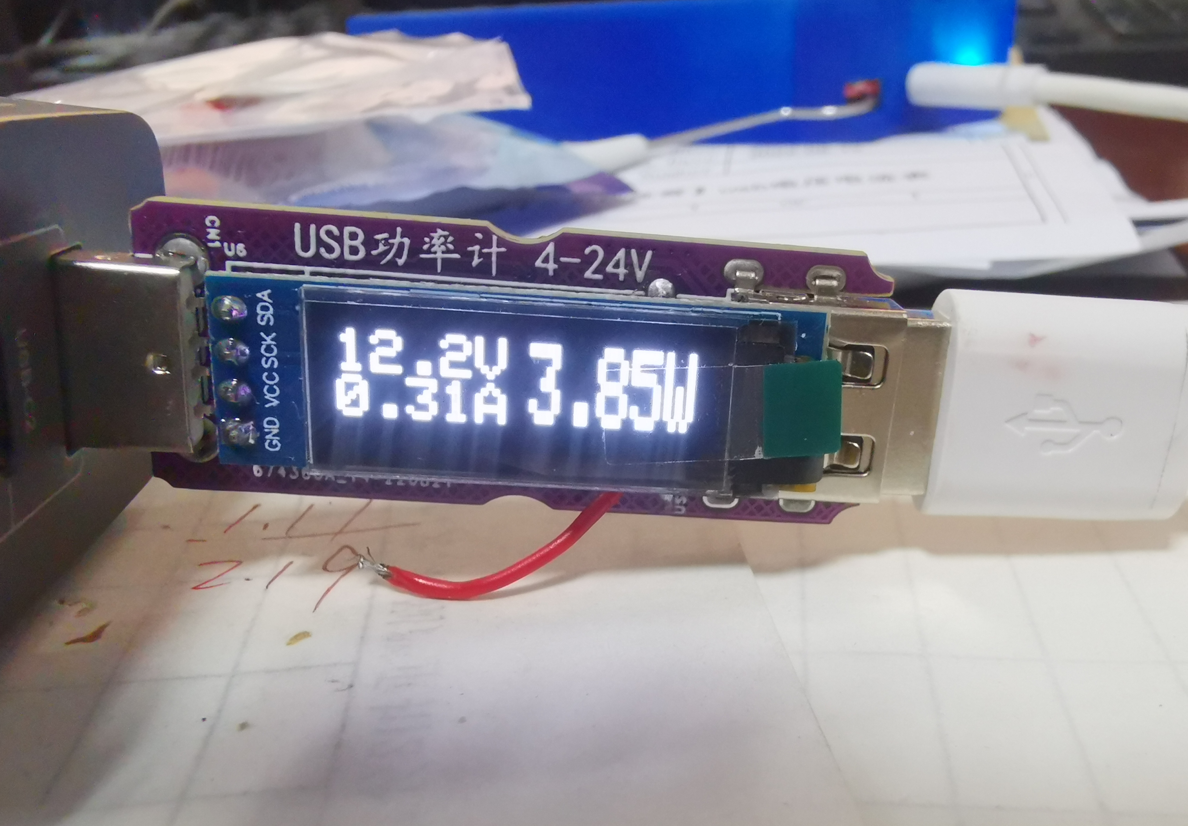

USB ammeter based on N32G430C8L7+INA199, with an accuracy of 1%. It can check the current when USB is working and supports fast charging.
*2. Project properties:
This USB power meter supports fast charging. The DCDC chip BL9342 in the voltage conversion circuit has insufficient power supply. When the voltage is around 5V, the output is only 2.5V, which causes the power meter to not work. Later, it was replaced with MP2451 to solve the problem.

If the sampled voltage or current is inaccurate, you can modify the values ​​of VOLTAGE_FACTOR and CURRENT_FACTOR in the main.c file according to the actual value. The specific calculation formula is:
VOLTAGE_FACTOR = actual voltage / displayed voltage
CURRENT_FACTOR = actual current / displayed current
