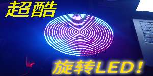

This is a rotating LED light panel based on ESP8266 and TLC5947 chips. It uses ESP8266 as the main control chip and TLC5947 LED constant current driver. It has high brightness, fast speed, and supports WiFi direct image transmission. The motor and power supply module can be designed by yourself, or you can directly purchase the module from Taobao. The program is written using the Arduino for ESP8266 framework. For the code, please see https://github.com/jj11hh/ESP_POV
Instructions for use: Connect the power supply, use the computer to search for the connection hotspot "ESP_POV", and after connecting, open the browser to browse http://192.168.1.1 to open the control interface. In the control interface, you can transfer new images and change brightness, Gamma, Rotation angle and other parameters.
