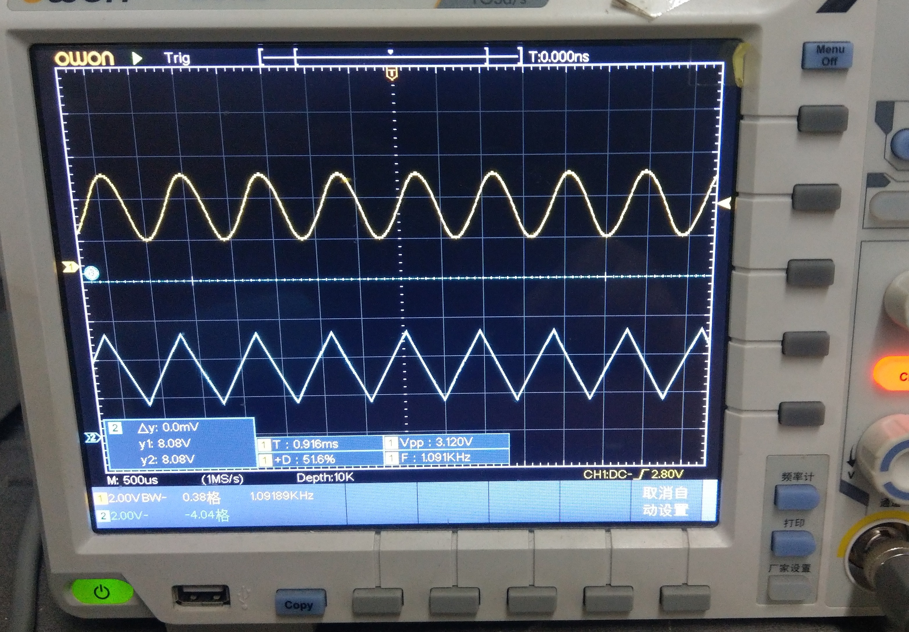

This is a multi-waveform generator made using LMV324 and 74HC74D. It can output high-frequency and low-frequency square waves, triangle waves, and sine waves. Project function: After the circuit is powered on the left DC interface or USB interface, the pins will output high respectively. Frequency square wave, low frequency square wave, triangle wave, sine wave signal. At this time, the frequency, integration speed, triangle wave DC component size and sine wave amplitude can be adjusted respectively through the four precision potentiometers on the board. Among them, the high frequency square wave The wave is obtained by the operational amplifier hysteresis comparator. The low-frequency square wave is obtained by dividing the high-frequency square wave by four by 74HC74. The triangular wave is obtained by the integrating circuit composed of the LMV324 operational amplifier. The sine wave is obtained by the second-order infinite gain multi-channel feedback composed of the operational amplifier. The filter is obtained by filtering the triangle wave. The on-board capacitor filters the power supply, resulting in a stable and pure waveform.
