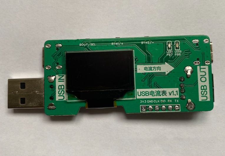

The ammeter implemented by National Technology MCU N32G430 supports voltage, current, power, ripple and current fluctuation graphic display.

The finished product picture is also released for you to see, it is still relatively small, and a TYPE-C port is added, which is also more convenient.
The PCB that was sent back has been revised because the first version found that the hole left by the OLED soldering screen cable could not be put in. ^-^
The soldered style, I originally wanted to take a working picture, but found that the screen flickered a lot, and the display content was incomplete, so I simply put it up when recording a video later.
Three buttons can be used to easily achieve some switching, parameter adjustment, etc.

*4. Hardware part
(1) Power supply part
Here, LDO is selected for power supply. In order to be compatible with fast charging, GM7333 is selected. This LDO supports an input voltage of 40V and supports a current output capacity of 250mA, which fully meets the power supply requirements of this national MCU. In addition, the peripheral circuit is simple, more convenient than using a step-down circuit, and the size is also smaller.
(2) The main control circuit
mainly uses four ADCs to sample voltage, current and the voltage of D+ and D-. BOOT0, PB0 and PB1 are used as buttons. RST is also brought out for debugging.
Then there are the serial port and SWD burning port. PB6 and PB7 are used as LEDs to facilitate program observation. After all, it is a novice, so it is also good to leave an extra status light to judge whether the system is running normally. It can also be used as a functional light later.
(3) Current sampling
    The current sampling uses INA199A1 for differential amplification. In fact, operational amplifiers can also be used, but it is best to use precision operational amplifiers. However, the accuracy of differential resistors should be high. Otherwise, the error between different hardware is relatively large, which is more troublesome, and there are more components. There is no cost advantage, so it is more convenient to use a dedicated current amplifier.
    Here we should pay attention to the A1 after the model. A means the accuracy is 1.5% (AB accuracy is 1.5%, C is 1%, please refer to the manual for details), 1 means the magnification is 50 times, 2 means 100 times, 3 means 200 times, that is, A1 means 50 times magnification and 1.5% accuracy. The selection is mainly related to the sampling resistor and the sampling voltage of the MCU. I will not go into details. If you want to know more, you can discuss with each other.
(4) There is actually nothing to say about voltage sampling
. It is just to divide the voltage and then sample it. The voltage here is sampled using 1:10, that is, the final calculated value multiplied by 10 is the actual voltage, D+ D- is 1:3, and the result is multiplied by 3. The voltage division calculation is Vadc=VIN*R2/(R1+R2), R2 is the low-side resistor, which is the one connected to GND. Note: The maximum voltage after voltage division cannot exceed the supply voltage (here is 3.3V), otherwise it will always be 3.3V and the true value cannot be obtained.
(5) OLED drive circuit
I use a 30P welded OLED screen, which supports SSD1306 and SH1106. I use the SH1106 white light 0.96 screen. This screen is relatively cheap on a certain fish, only 4-5 yuan each. You can consider buying more and putting them away for easy use. Of course, an OLED external interface is also reserved.
