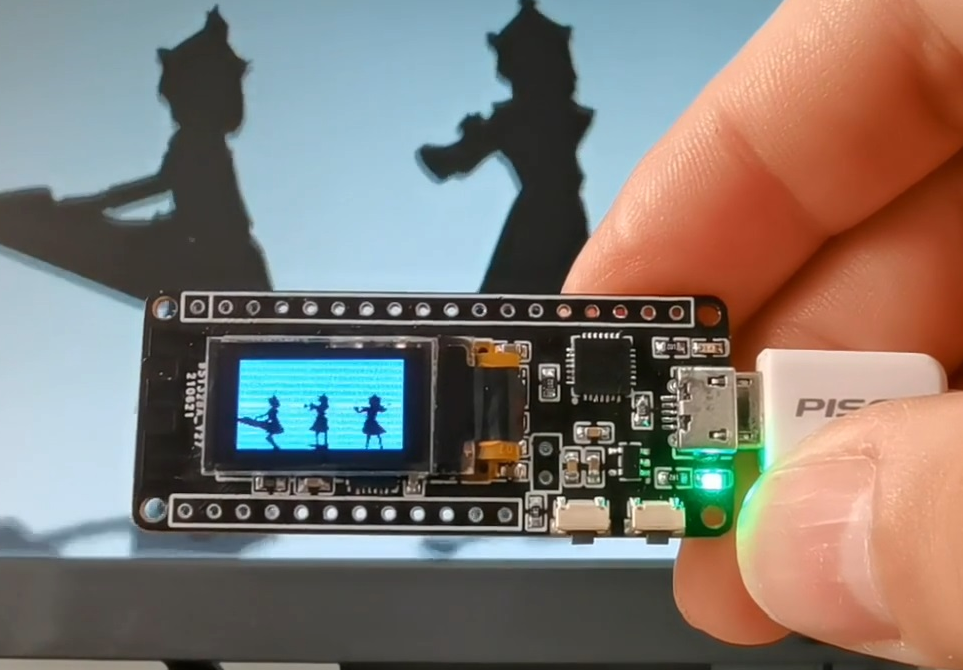

Imitation of Zhihuijun ESP32 development board
Zhihuijun The project address is https://github.com/peng-zhihui/ESP32-PicoDK
The size of the development board has not changed and the pins have not changed. The resistor and capacitor components have been replaced with 0603 packages, which is easier to solder. The TYPE C USB interface has been replaced with micro USB, and the ceramic patch antenna has been replaced with a printed antenna.
Test address of station B: imitation of Zhihuijun ESP32 development board, screen projection test to play BADAPPLE
For the TYPE C version, please go to https://oshwhub.com/yiplay/esp32-01-type-c_copy
