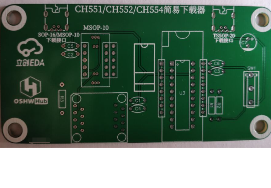

CH55x series simple downloader
Instructions for use: Open WCHISPTool on the computer, select the microcontroller model, and connect the computer to the USB download port with a USB cable. Select the program file, click Search in the USB device list. Then click Download.
Isolation column purchase link: https://item.taobao.com/item.htm?id=530551927091 ( Color classification: G221-06-100 capsules )
Burner socket purchase link:
TSSOP-20 programming socket (plastic body width 4.4mm): https://item.taobao.com/item.htm?id=520002622038
MSOP-10 with board programming seat (plastic body width 3mm): https://item.taobao.com/item.htm?id=524933101915
SOP-16 narrow body programming socket (plastic body width 3.9mm): https://item.taobao.com/item.htm?id=45616378399
Since the MSOP-10 programming socket is relatively expensive and not commonly used, it is not recommended to be soldered directly on this simple downloader.
It is recommended to weld two headers on a simple downloader (the spacing between headers is 10mm) and buy a socket with a header adapter plate.
Photos of actual empty PCB
