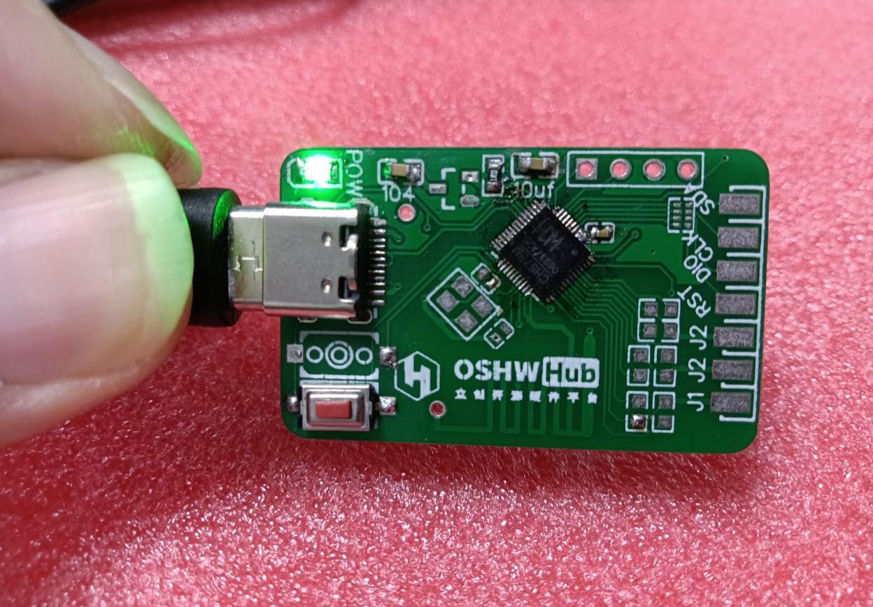

(1) Prepare the materials before welding (see BOM list for specific materials), which can effectively reduce the welding debugging time during welding.
(2) After soldering the typec connector, ams1117 and filter capacitor, you can start soldering ch579. This qfn is asymmetrical and tight. For an amateur like me, welding will be very difficult.
After plugging in, wch information will be displayed
Since it is an empty chip, the device can be recognized immediately in WCHISPTool.
After welding the finished product.
Since the 32M crystal oscillator and capacitor are not soldered, CLK_SOURCE_HSE_32MHz needs to be changed to CLK_SOURCE_HSI_32MHz.
