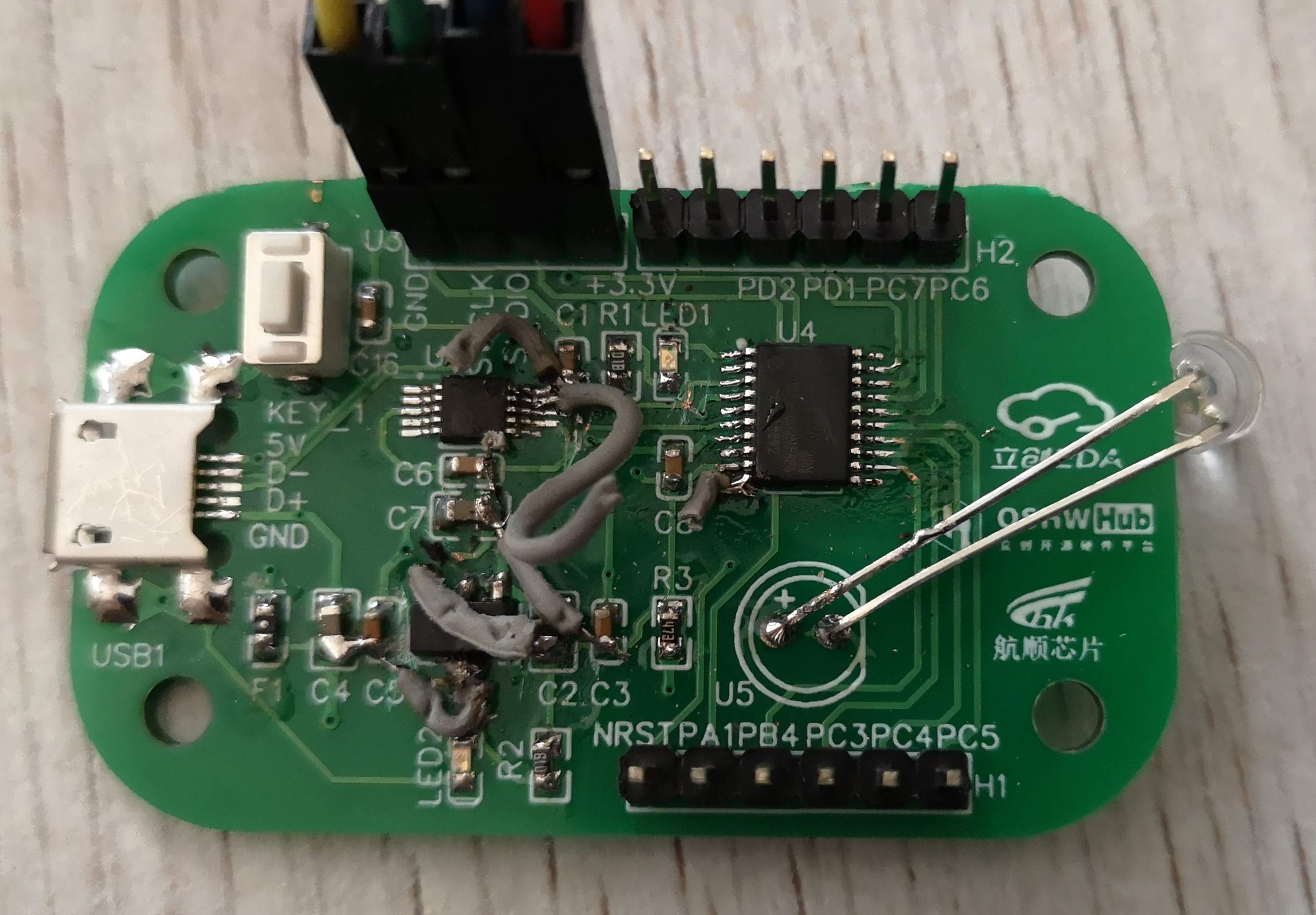

Problems encountered:
After the welding was completed, the output 3.3V voltage was incorrect. The inspection found that there were two reasons for the incorrect output 3.3V voltage.
1. Schematic packaging problem. Use Hangshun's HK7333-A power chip. Directly search the official packaging library of C495410 as follows. The schematic library of SOT23-3 is used, while C495410 should use the schematic library of SOT89-3, which needs to be modified by yourself. .picture.png
The datasheet pinouts are as follows:
Disconnect the wires and fly the wires. This time it will be ok. After powering on and testing, I found that the output voltage is still wrong. Please see item 2 for the cause of incorrect voltage. 2. The power supply of the USB to serial port is 5V, which causes the voltage of the microcontroller to change, that is, the 3.3V output by the LDO becomes more than 4V. Original picture 5V power supply:
Modified 3.3V power supply:
If you still use 5V power supply, you can also connect a transistor to the serial port for voltage conversion. Being lazy here, I just disconnected the serial port line.
The above problems can actually be avoided by reading the data sheet. Remember to read the data sheet carefully for unused chips!
Problems encountered when testing ST-LINK and ULINK programming programs respectively: I have an ST-LINK and ULINK on hand. First use ST-LINK to download and connect the used pins to the SWD port of the board through a cable. The sequence of ST-LINK The phone number can be recognized but the SWD port cannot be recognized. I am completely speechless. . . . I accidentally discovered that when I disconnect the power supply, SWD will be recognized. At this time, the download will report an error, but it doesn't matter if I click once and the download will be successful. At this time, when powering on, the LED indicator light flashes normally, and the phenomenon is normal. Use ULINK to download and test everything is normal. Therefore it is not recommended to use ST-LINK to download.
