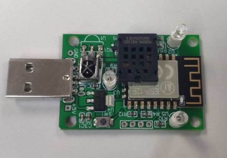

Infrared learning remote control based on Blinker and ESP8266
WIFI infrared learning remote control can learn infrared remote control signals, control remotely, and view temperature and humidity information.
Burning method
(1) Hold down the button and power on the module
(2) Connect RX and TX to the serial port
(3) Upload to Arduino
(4) Power off and restart
the network distribution method
(1) Search the ESP_AP WiFi signal and password on your mobile phone 12345678
(2) Enter your home WiFi name and password on the pop-up interface, and then enter the key applied for by Blinker
(3) Click Save to complete the network configuration
Learning method
(1) After the device is online, press and hold the button that needs to be paired for 3 seconds, and the color of the button will turn gray
(2) Aim the remote control at the infrared receiver, and press the button that needs to be learned
(3) Press and hold the button that turns gray and continue 3s, the color returns to normal and the learning is completed
(4) Operate the Blinker interface to see if you can control the air conditioner
(5) Other buttons are similar to
turning on or off the air conditioner at a scheduled time
(1) Click the alarm clock icon
(2) Select an action (turn on or off the air conditioner)
( 3) Set the action time
for other intelligent scenarios, such as automatically turning on the air conditioner when the temperature is high, etc. Please explore by yourself
Notes
1 DHT11 often has NA, the reason is unknown, AM2320 does not have this problem
2 You can change the NA in the DHT library to -1024, so that it does not affect the use
3 The buttons support learning 10, and the learned information is placed in FS , the EEPROM cannot hold
4. Some air-conditioning buttons are combined (such as power on + setting). Currently, only the first one (power on command) is recognized.
