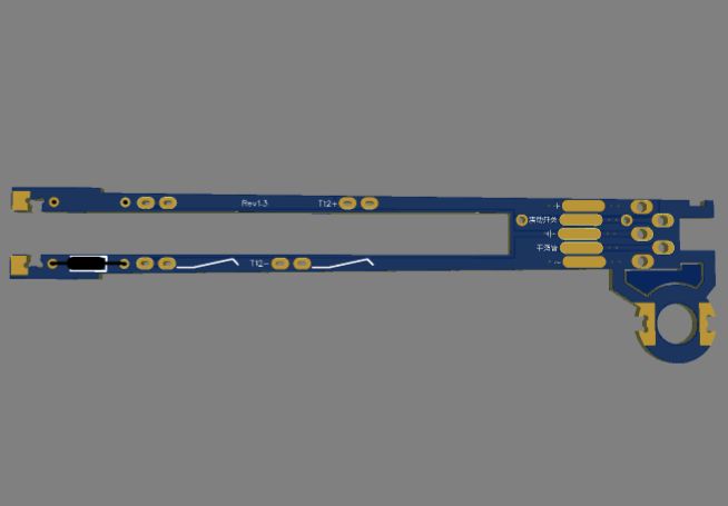

1. Reasons for development: When a common vibration switch is used, it will trigger the soldering station to sleep when it vibrates at a small amplitude, and the sleep time needs to be delayed for several minutes, which is not conducive to extending the life of the soldering iron tip. Magnetic hibernation is a better solution. The purpose of developing this T12 handle bracket is to adapt to the Suzaku T12 soldering station that supports magnetic sleep .
2. The vibration switch (normally open type) and the reed switch (normally open type) are each assigned a line, that is, the hardware supports two sleep modes, which are selected by the software; during sleep, the trigger level is high and low (vibration switch high level Trigger sleep, reed switch low level triggers sleep), so you can only choose one of the two and cannot use them at the same time.
3. Applicable handles:
4. The width of the bracket PCB has been widened based on the actual width inside the handle I purchased to increase the wiring width. The PCB width is larger than the 907 to T12 bracket on the market. PCB length 100mm.
5. It is found that the schematic diagram displayed on the web page below is not updated. Please refer to the one opened in the editor.
6. Change record:
Rev1.3 2021/12/2
Optimize bracket connection pad
Rev1.2 2021/11/28
The soldering iron shell is connected to T12-separately, which can be used when only the soldering iron shell is grounded.
Rev1.1 2021/11/15
Add via holes at both ends of the patch pad to improve the strength of the pad:
Special reminder: This solution has not been verified yet. If you encounter any questions, please leave a message.
