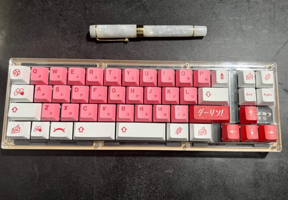

is called Tianzi 40 for short, and it is inspired by Tianzi 68.
As a 40 lover,
I have a Tianzi 68 from Huadan Niang,
but 68 is definitely too big for me
, so I made a Tianzi 40 for my own use.
It has been a while since I started making this keyboard.
At that time, the price of 32u4 was rising wildly.
The big guy of B station: Full-bridge Activator just released a teaching video of 32A ,
so I started to copy
homework. The pcb was actually made a few months ago, but
I was too lazy to make the shell. Now I just made one to do a test.
There is no problem after the test. Some friends have reported rgb problems and delay problems before.
I used it for a few days and didn’t find any major problems. Maybe I have fewer rgb. I only made four rgb lights.
There is no problem with daily typing. The game has not been tested.
32A is a toy, and it is open source for everyone to play with. The entertainment cost is not very high
. Brothers who like 40 can play with it by themselves.
The board is single-key slotted, and the shell is also made of gasket structure.
