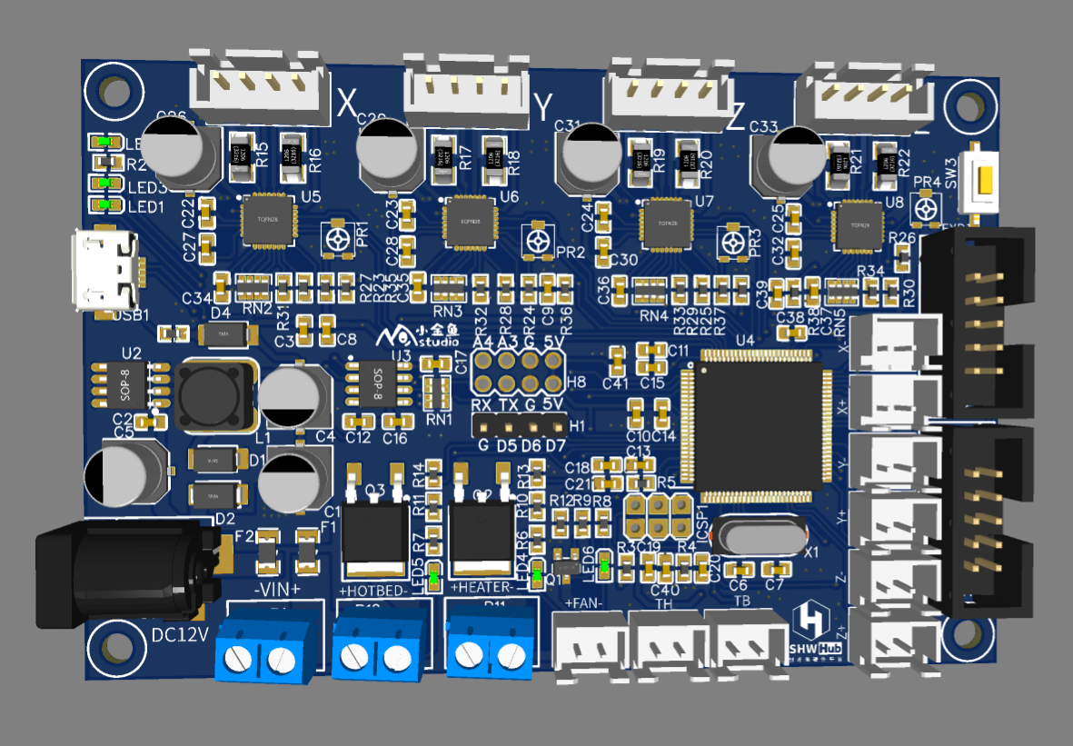

1. This control board combines ramps1.4 and maga2560, uses a more convenient micro USB interface to flash firmware, and uses CH330 USB communication IC
2. Using A4988 motor driver chip, the default is 16 subdivisions
3. Two-layer board design, length and width not exceeding 10*10cm. Economical and compact
4. Using xl1509 dedicated DC-DC power chip, supporting 12V and 24V power input
5. The firmware can use the open source firmware Marlin. The configuration is exactly the same as ramps1.4 and can directly replace ramps1.4.
6. This design part refers to the MKS MINI V2.0 3D printer motherboard
7. This design has not yet been verified and there may be some minor problems.
