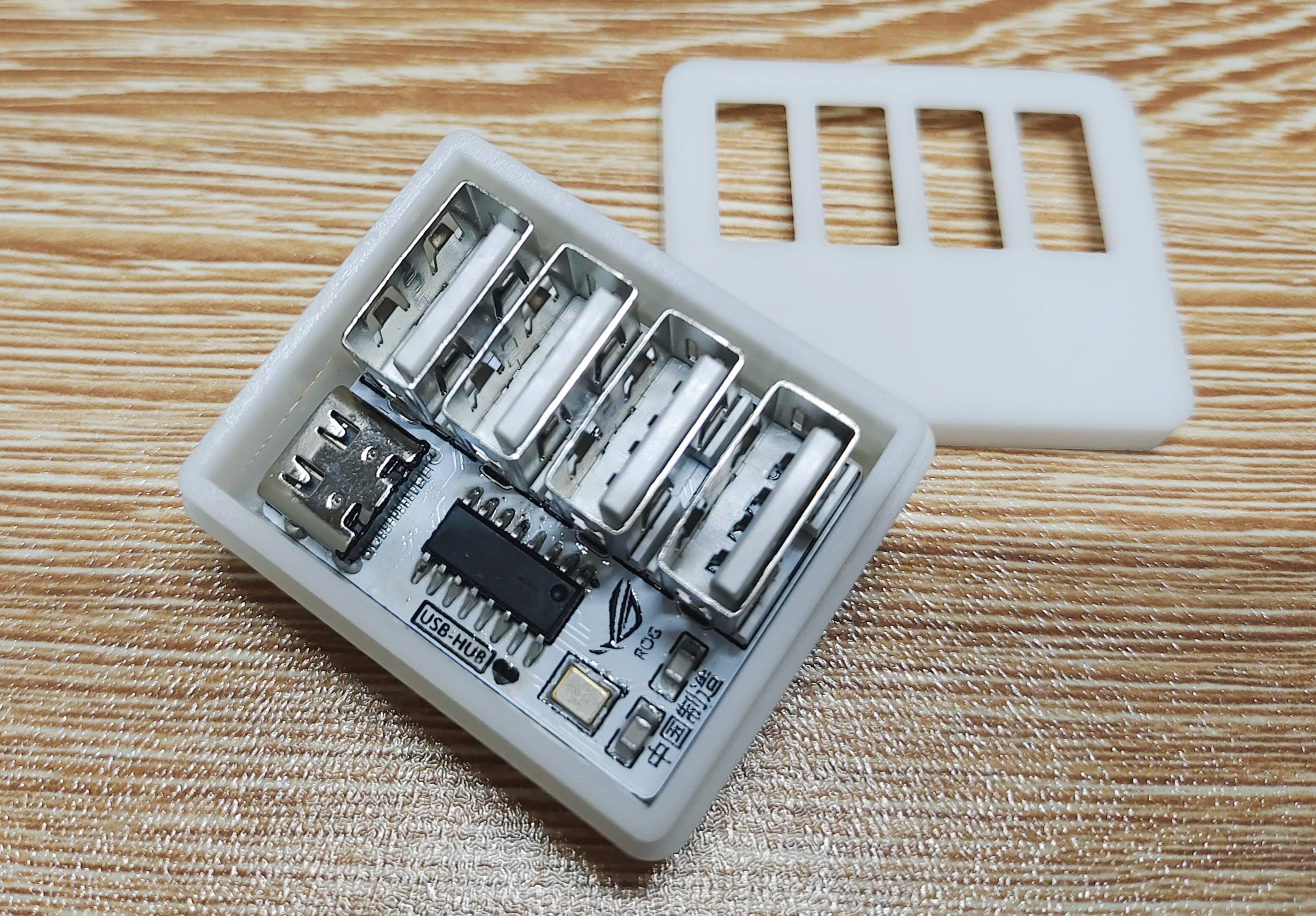

As you can see, the functions implemented by this board are very simple:
1. Expand one USB port to 4 USB ports to increase the number of devices that can be connected to the computer
2. The size is small enough to put it in your pocket! I took it away q(≧▽≦q) 30mm X 25mm size
3. It was measured that all four USB-A ports can be fully plugged in and will not be blocked by each other (unless you use a non-male USB-A male plug)
4. The expansion dock is separated from the cable, so you can freely change the type of cable, the length of the cable, and the colorfulness of the cable. It is not only convenient to store but also beautiful!
5. My two 2.4G receivers occupy two USB3.0A ports, so every time I want to plug in a USB flash drive, I have to unplug a receiver, because the bandwidth required by the 2.4G receiver is not large, USB2.0 is more than enough, occupying one USB3.0A port and leaving another USB3.0A port free.

3D shell design
PCB: [Unmodified version of the original project]
The opening of the 3D shell in the TYPE-C interface is very large, and the male head
of the data cable can be directly plugged in to prevent the data cable from protruding. Taking into account that everyone is replicating, some of the data cables bought by everyone have very large TYPE-C male heads that cannot be plugged in,
so another version is specially designed PCB: [Compatible with 3D shell version] Make the TYPE-C interface protrude outward, perfectly compatible with all lines that can be inserted normally without being blocked.
You may be curious why the holes in the TYPE-C interface of the 3D shell are tilted downward, because there is some space under the board. If the pins of the through-hole components at the bottom are not particularly prominent and
you don’t put some paper under them~the board will sink and the whole will move downward, and it will be inconvenient to insert the TYPE-C interface. This design can ensure that the board has margin for up and down displacement.
