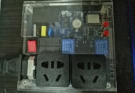

1. Two-way smart socket, main control ESP12F, this design uses the lighting IoT platform, and has been physically verified for several months.
2. The board is designed with a DS1307 clock module, which is convenient for DIY and web control to provide time without an IoT platform. There is a battery, so the time will not be lost when the power is off.
The AC power input port is only one of the three computer sockets, which is convenient for wiring. The power module adopts HLKPM01 to 5V. The most important thing for a product is safety. This design
It is equipped with safety components, 10A fuse and 0.5A for the module. There is a window on the back of the PCB board to allow tin to carry out large currents. The ship type switch is the main switch. There are two more buttons
It can be used to manually control the socket, and the board leads to the programming serial port.
3. Acrylic shell cad file, the program is in the attachment. There are four 15mm threaded holes at both ends of the plastic column. The plastic column has a nut on one end, a threaded hole on one end and a screw on the other. Not counting the 10mm long thread, four M3 screws and four nuts. .
Boiling a kettle of water is no problem
