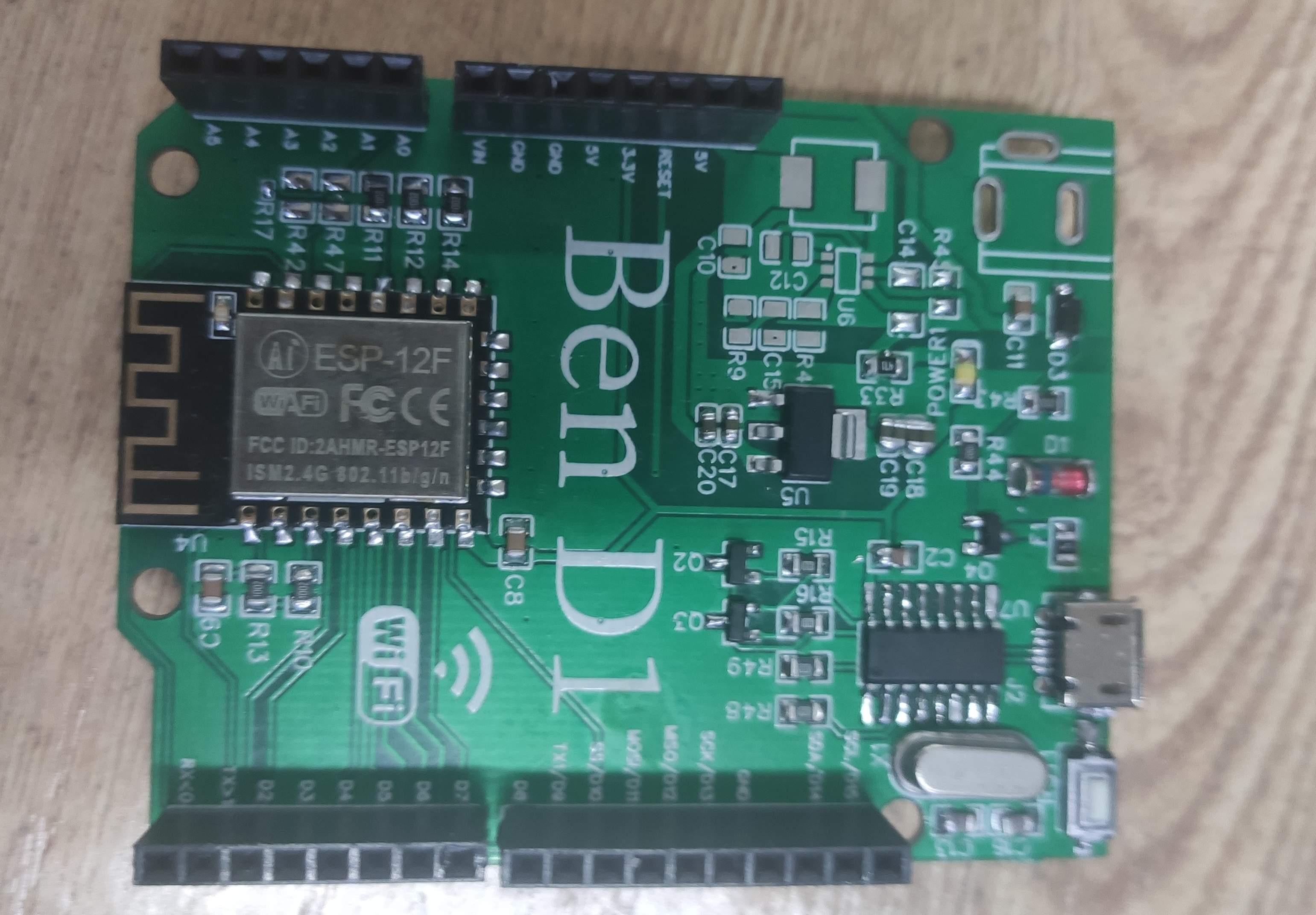

For the esp8266 development board, it is recommended to go to csdn to read the tutorial by the rookie brother. I personally think it is the best tutorial currently developed for esp8266arduino. Resistors R3 and R4 play the role of voltage divider. Because the maximum adc of 8266 is 1v, it needs to be divided when connected to 3.3. You can leave r7 unconnected, or connect it to a capacitor filter, or you can consider shorting it directly, but remember that the maximum input voltage is 1v. You don’t need to weld the unused parts of the switching power supply (that is, the parts I did not weld)
