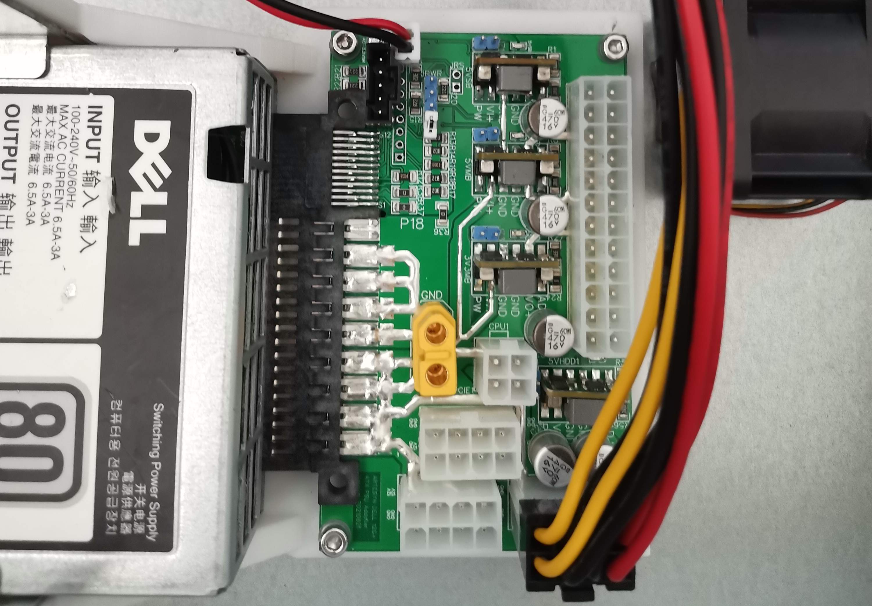

Dell server power adapter board-ATX24pin+12VO-integrated buck
Compatible with Dell 12th and 13th generation server power supplies (R720, R730, etc.). Others have not been tested. It may be that
the 24pin wire sequence is different. If you want to change the wire sequence, you cannot plug it in directly!
About Ver2: There are two 8pin graphics card cable sequences and one hard disk cable sequence. To connect the hard disk, an adapter cable is required. It is recommended to buy tools and crimp them yourself.
Note on the line sequence: there is no -5V and -12V, there is an extra 12Vsb, the wiring is connected as needed, the remaining wires can be left floating to
reduce the voltage. The module needs a fan for heating. Shorting the jumper next to each module means disabling this module.
Reference component model:
Connector: 10107844-002LF/003LF
Buck module: ZXDN10S1205SAW
Connectors: XT60PB, 5557, XH2.54, TJC8
