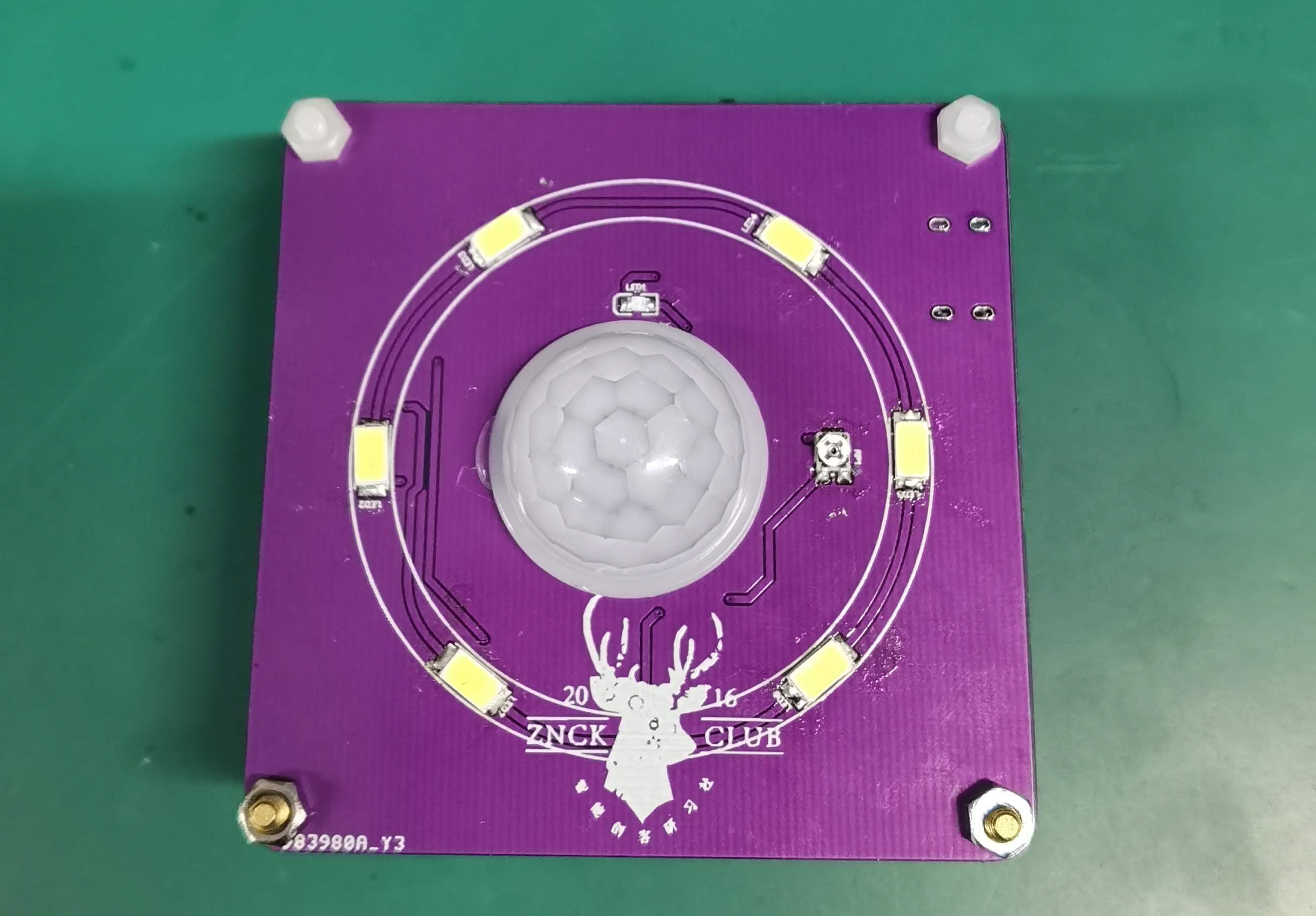

Through infrared sensing, it emits light when detecting human activity in dark places. Can be used in dark places such as cupboards and aisles.
Control repeatable triggering and non-repeatable triggering through sliding switch SW2. The output delay time Tx is adjusted by the size of the external R7 and C3, and the value is Tx≈49152xR7C3; the trigger blocking time Ti is adjusted by the size of the external R6 and C5, and the value is Ti≈24xR6C5. .
