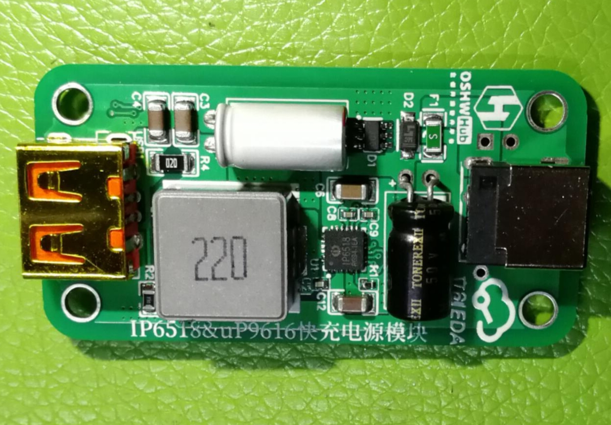

Main control solution: Battery power management chip IP6518 DC5.5 interface input, power supply voltage 8v-28V. Output is TYPEA TYPEC 2 selected interface. The motherboard adds input one-time insurance, input 28vTVS, DD data TVS. There are 2 output indicator lights. 5V lights up one LED, and when fast charging is activated, two LEDs light up at the same time. The front is an IP6515 solution, and the back of the PCB has a compatible circuit uP9616.
