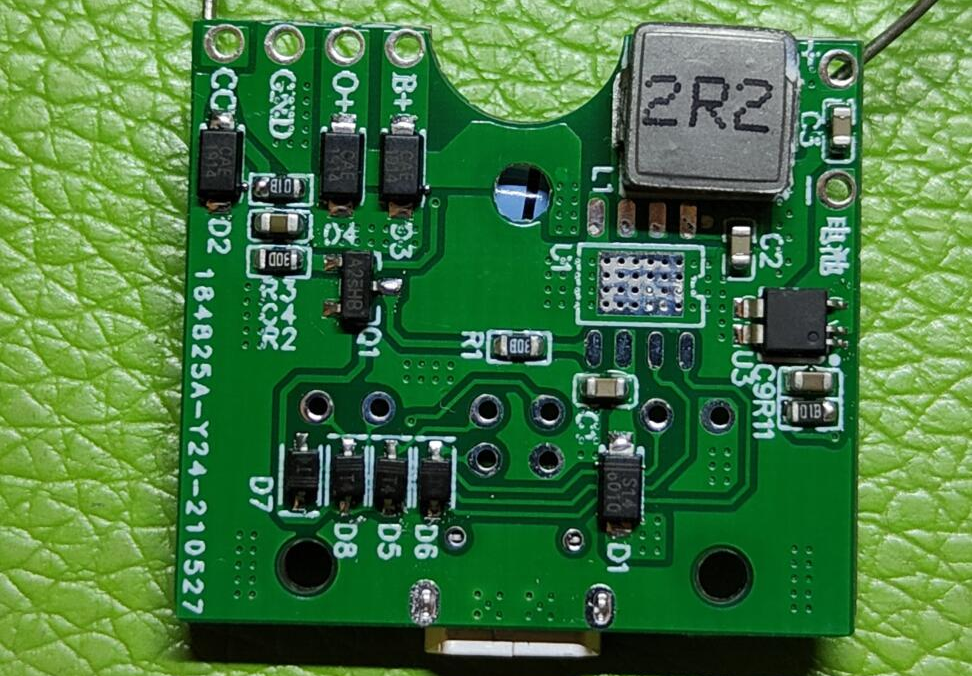

Verification scheme. Modified electric mosquito swatter.
For details, please see
https://www.mydigit.cn/forum.php?mod=viewthread&tid=257779
The data obtained by actually testing this chip is not good.
PDF data standby 50-80uA. The actual static voltage when fully charged at 4.2V has exceeded 100uA.
And the settings of the indicator lights are not reasonable. PDF requires that the LED vf value must be greater than 2.8V.
The LEDs in Yangtze River are basically not higher than 2v, so you have to look for LEDs with high vf values.
A level 4148 has been added to this solution and will still make the LED slightly brighter.
