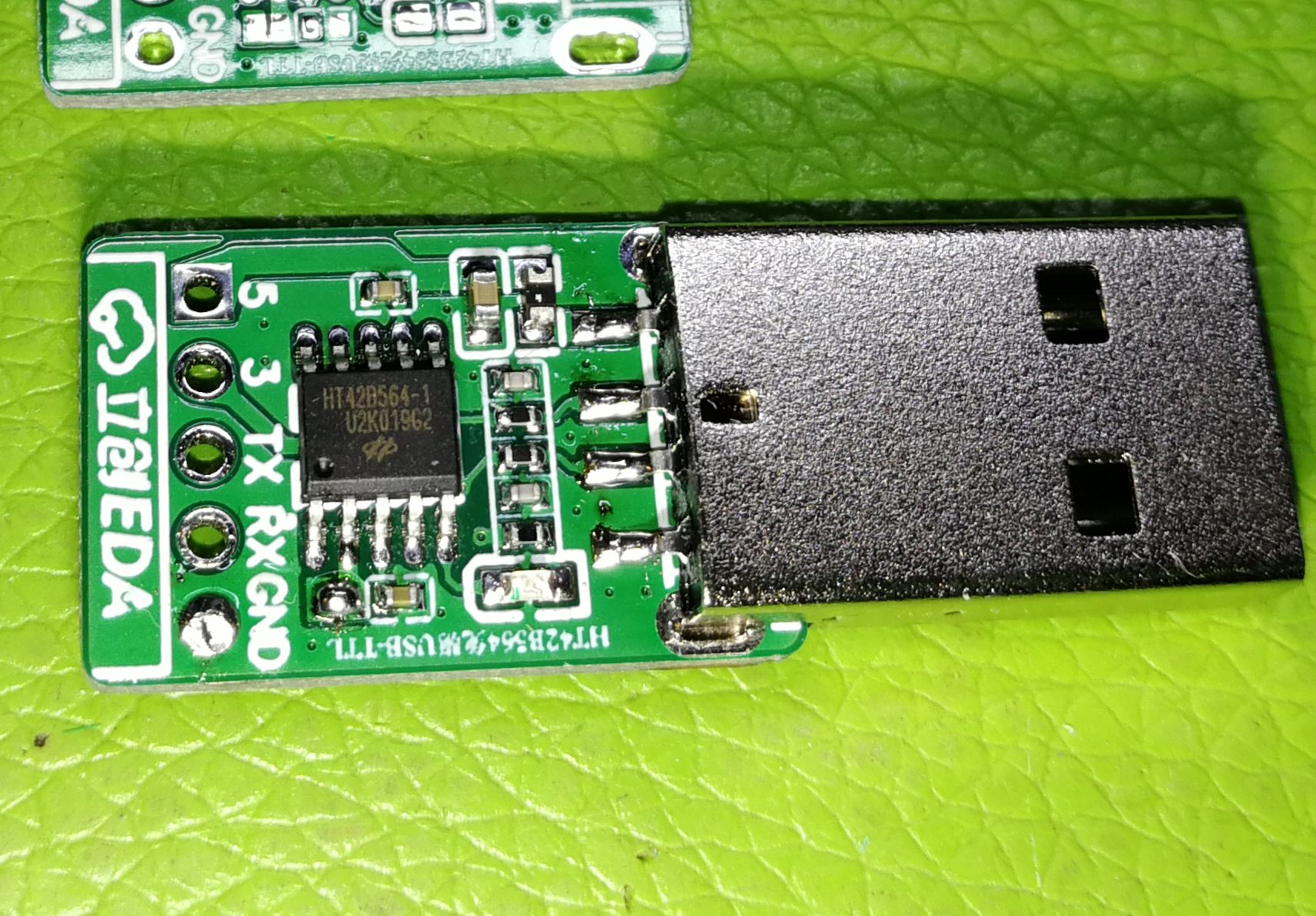

A very simple driver-free USB-TLL serial port chip.
When laying out the board, I found that the pin order of this chip was a bit strange. Need to go around. Not very humane.
USBA interface input. The interface has 5V and 3.3v. . . Can directly power the target board.
Enter a 500ma self-restoring insurance.
