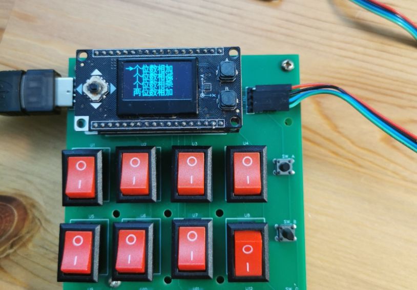

In order to better respond to the national double reduction policy, cultivate talents who are useful to society, and reduce the burden of putting myself to sleep, I created a "night calculation trainer".
The training method is to randomly generate operational expressions and then require user input through voice broadcast. Of course, in order to save space, three sets of ship-shaped switches are used to input via 8421 codes. Each "1" of the binary code in the 8421 code represents a fixed value. Add up the binary numbers represented by each "1" to get the decimal number it represents. Because each "1" in the code represents the numbers "8", "4", "2" and "1" from left to right, it is named 8421 code. For example: input 1001 means 8+1=9. In this way, 12 switches can represent 0-999 numbers. Of course, if you go to higher grades in the future, you can consider using 10 switches to represent numbers from 0-1023. For hardware, we use the ESP32 FireBeetle produced by DFRobot, the matching Firefly OLED12864 display and the Gravity Chinese and English speech synthesis module (based on the XFS5152 chip), and then there is a boat-shaped switch for input. Next, we start the hardware design. The overall circuit diagram is as follows:
The upper left corner is a part used to consume power and ensure that it can still work normally when the power bank is powered (most power banks will automatically cut off the power supply after a period of time when the current is less than 100ma. Here you can use the timer to Pull out a current for a while to avoid this). In the upper middle is a USB Type A male connector for external power input. That is to say, this design can use Micro USB on FireBeetle or USBTypeA for power supply. Special attention needs to be paid to avoid both working at the same time to avoid the problem of current backflow. The lower left corner is a keyboard matrix design, in which diodes are used to ensure that there will be no misjudgments, so that it can be judged when multiple keys are pressed at the same time. The specific implementation is carried out by dynamic scanning, for example: first pull KEY_ROW1 high while keeping KEY_ROW2 and KEY_ROW3 low. At this time, if U1-U4 are connected, the corresponding KEY_COLx will appear high level. Next, perform similar operations on KEY_ROW2... This will enable scanning and judgment of all key inputs.
The voice module supports serial port and I2C. Here we choose I2C, which has a resistor pulled up to 3.3V.
You can see that there are three buttons on the board. Through these buttons, you can select the menu, confirm and submit the input results, return to the main menu and replay the question. Not all pins of the core ESP32 can be used as GPIO. If there is any improper use, it will cause repeated restarts. This design of IO is very tight:
Because of the existence of the boat-shaped switch, the overall PCB is larger and the wiring can be completed easily:
3D rendering
Get it and assemble it:
Next, we start to design the software part. The state transition diagram of the code is as follows:
