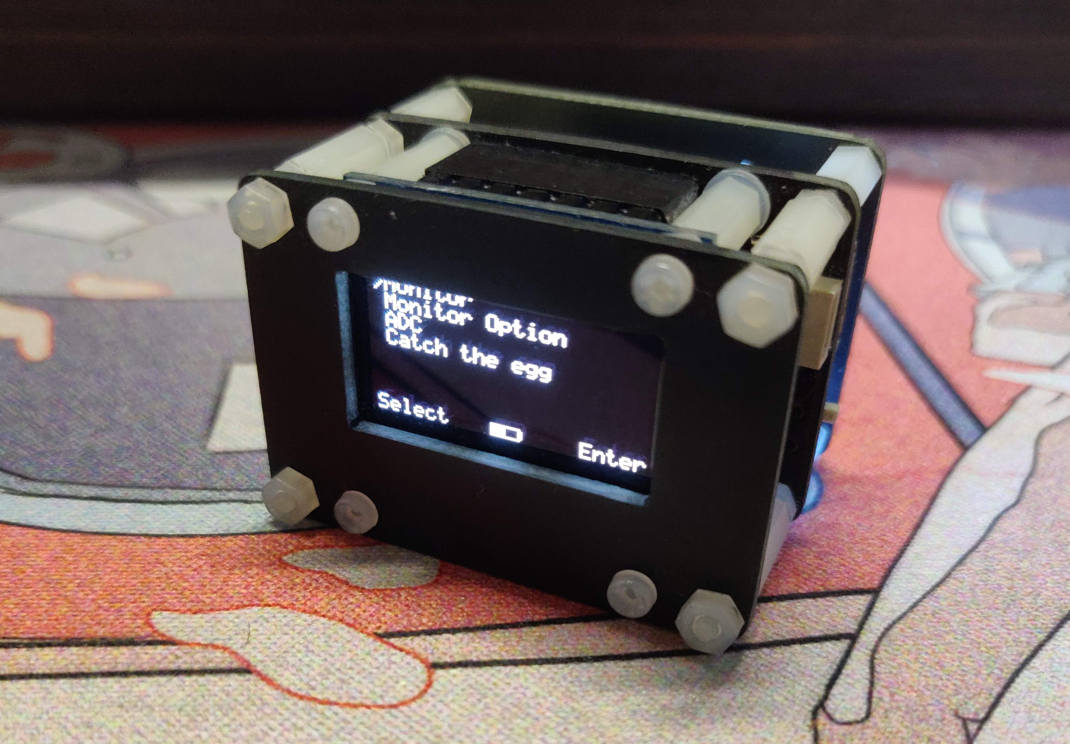

A simple and useless offline serial port monitor (hereinafter referred to as the monitor), the main control is MSP430G2553, which is connected to the target serial port through the serial port and can display the received serial port information.
Function
  • A simple serial port monitor that is similar to a serial port assistant on a computer
  • Simple serial port configuration, such as baud rate, parity, stop bits, etc.
  • Dual 2.5V range 10-bit ADC
  • A very addictive little game

This project uses MSP430G2 LaunchPad as the programmer. I am not sure whether the new version of MSP-EXP430G2ET LaunchPad can be used. When using it, you need to remove the MSP430G2553 on the LaunchPad and connect it to the debug interface of the MSP430G2553 on the monitor through several lines as shown in the figure. LaunchPad burning connection
Burn
In CCS, import the project through Project -> Import CCS Project... If it prompts that the import fails, check Copy projects into workspace. After successfully importing the project, compile and burn, or when debugging, it is recommended to disconnect the power of the monitor. , after successful startup using the power provided by LaunchPad, the following interface should be displayed Main menu interface and the following information will be output on the TX pin at a baud rate of 9600

PCB physical picture
forwardback Please don't worry about the oil marks all over the board. The solder paste placed there has deteriorated due to the high temperature, and I accidentally added a little too much when soldering the board. I didn't wash the board with water yet, which resulted in oil marks all over the board.
Notice! ! !
Due to poor consideration, I used two ordinary capacitors for the input and output of the LDO when drawing the schematic diagram and PCB. However, when I was making the actual product, I thought of replacing it with two tantalum capacitors. However, tantalum capacitors have positive and negative poles, but the board There is no silk screen printing of positive and negative poles on the capacitor. If you want to use tantalum capacitors in the same way, please be sure to confirm the positive and negative poles, otherwise it is very likely to boom.
Serial monitor
Serial monitor screen Can display the content sent by the serial port of the microcontroller currently connected to
Serial port configuration
Serial port configuration Simple serial port configuration can be performed on the serial port monitor, including baud rate, parity bit, stop bit, number of data bits, data high and low first, and number of display lines.
ADC
ADC It can display A1, A2 and the BAT pin connected to the lithium battery for a total of three channels for measurement with a range of 2.5V. The BAT channel of the lithium battery divides the voltage through two 100k resistors, so it will not exceed the range.
Games
Games A small game of catching eggs, the functions added in a flash of inspiration are very similar to the small games I played on feature phones when I was a child.
