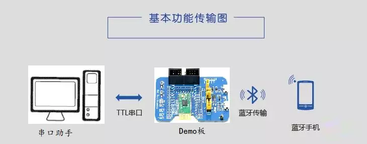

Introducing a Bluetooth case - a data transparent transmission application developed based on the MM32W series.
Figure Transparent transmission application connection transmission diagram
Speaking of how the low-power Bluetooth module works, it is indispensable to introduce the simplest and most common communication method in the low-power Bluetooth module - data transparent transmission. Transparent transmission is also called serial port transparent transmission, which means transparent transmission. Transparent transmission is a working method, not a function, and generally appears in serial port modules. In order to allow users to better develop Bluetooth wireless transmission products, the Smart MM32W series MCU does not need to worry about how to implement the internal Bluetooth protocol stack, and can quickly implement the functions of the serial port module. The specific working mechanism of the serial port module is that it does not do any processing on the data to be transmitted by the MCU , and does not need to add any protocols by itself. The user can control the size of the data packet and conduct bidirectional transmission between the APP .

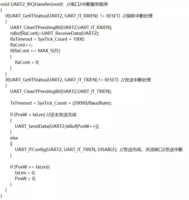

Combined with the hardware resources used above, below we focus on the software implementation process and related configuration code. Since this application scheme uses transparent transmission of data between the BLE chip and the APP , in order to avoid interference from other data, the broadcast messages at the application layer are cancelled, and there is no need to set the pairing mode; since this scheme uses the UART2 of the MCU , when using printf When debugging the printing function, it is necessary to switch the serial port used internally by the two library functions fputc and fgetc to UART2 , and use the query mode to print data, which is different from the transparent transmission method in this case ( interruption mode); in addition, the connection The pins of the status indicator light are configured to more intuitively observe and verify the application effect, and the watchdog reset function is enabled to ensure the stable performance of the Bluetooth service; due to the need for low power consumption in the solution application, this solution Low power consumption adopts SLEEP and STOP dual mode switching, and enters different low power consumption modes according to different timeouts.
The following initializes the configuration content of the main function. It mainly initializes all peripheral resources and the Bluetooth protocol stack, and runs Bluetooth in the form of an interrupt service program. The main functions implemented in the loop of the main function are to determine whether to enter low-power mode, based on The serial port receives and sends data during the timeout period to enter the low-power mode. The code is as follows:
pictureThe following focuses on several functions related to serial port 2 operations:
    /*** Serial port 2 sending data interface. When the MCU receives the Bluetooth transparent transmission data, the program will call this interface function. This function mainly implements loading the data to be sent into the TX BUFF and waiting for the serial port interrupt service program to process and send ** */

/*** When receiving data from the serial port assistant, the interrupt service routine processes the received BUFF loading data, and calls this function in the periodic callback function of the Bluetooth protocol to send the serial port assistant data to the APP***/

The dog-feeding operation is performed in the UsrProcCallback() processing function, and the receiving and sending operations of serial port 2 transparent transmission data are processed. The Bluetooth protocol will call back this function periodically, whether in the broadcast state or the connection state; in the serial port 2 interrupt service program It mainly implements the data loading and trigger sending functions of sending BUFF and receiving BUFF . The following is the code implementation content:

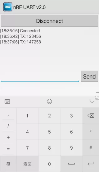

The mobile App uses nRF UART v2.0 App ( the Android version of the App installation package nRFUART_Googlev2.apk , which can also be found and downloaded from 360 Mobile Assistant ) ;
Open the nRF UART v2.0 App , click Connect to start searching for ble devices, select the Bluetooth device with the corresponding name ( MM32_UART2 ) and pair it, and wait for the connection to be successful. After the connection is successful, there will be a corresponding prompt, and the name of the button Connect will change to Disconnect ;

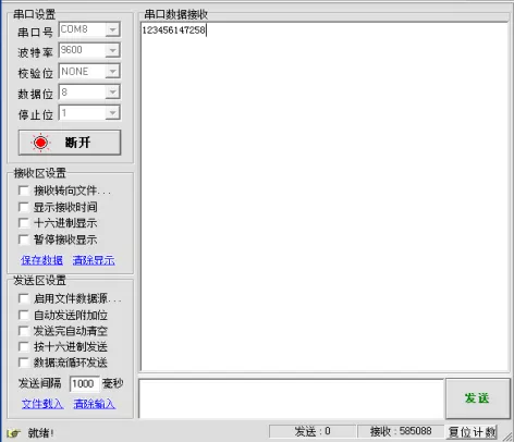

After the connection is successful, you can enter data in the App , and then click Send. The data sent by the mobile phone will be transparently transmitted to the test demo board for reception through Bluetooth, and sent to the serial port assistant on the PC through UART2 for display: For the convenience of demonstration, the serial port can be short-circuited. 2 ’s TX2 and RX2 pins, so that after the demo board receives the data sent by the mobile App , it will send the same data content to the mobile App for display.
Figure Mobile APP diagram and PC serial port assistant diagram
