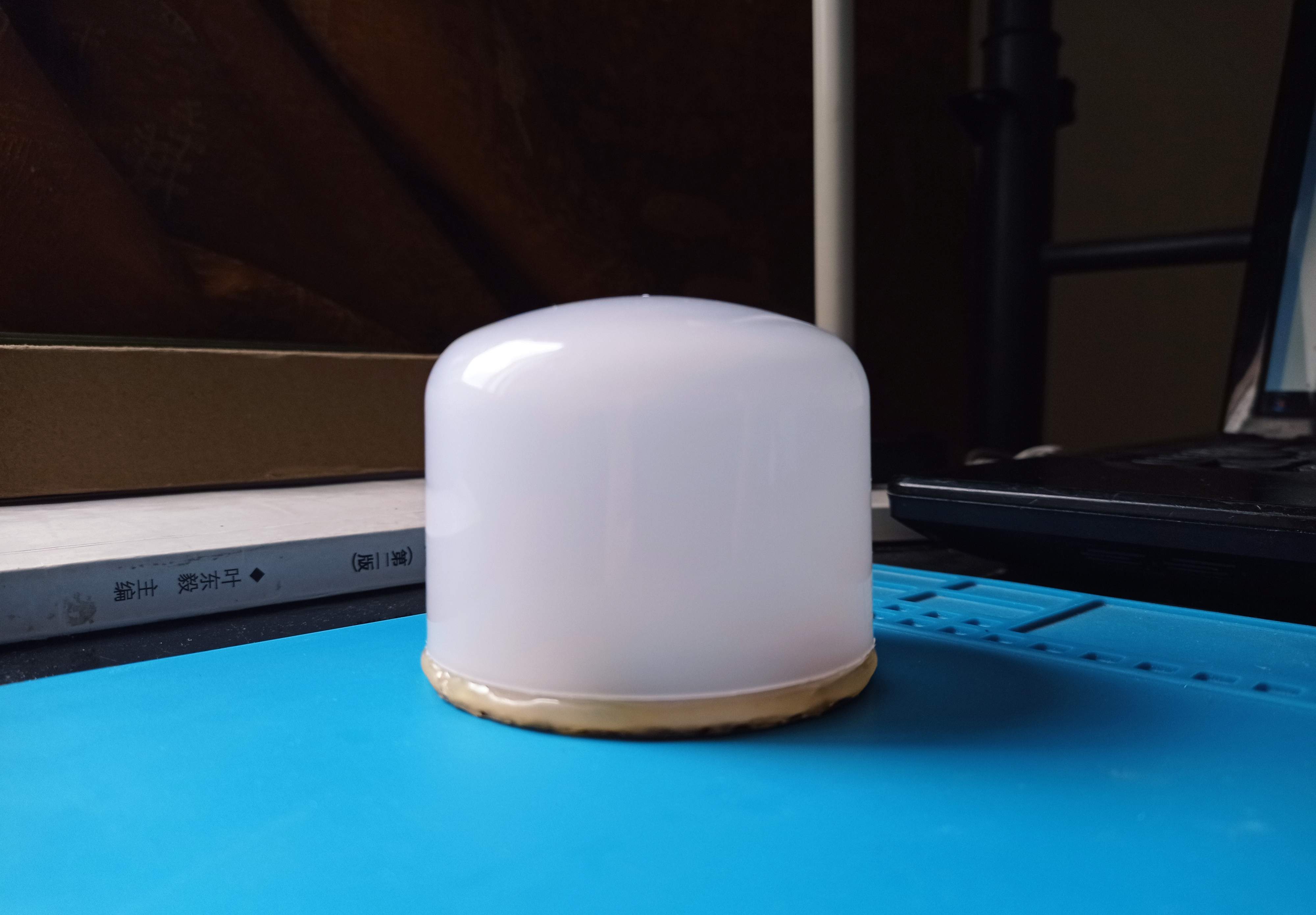

This is what it looks like after I use the energy-saving lamp shell as the lampshade and the paper shell from Lichuang Mall as the base plate. Underneath the black tape are the buttons.
Lighted renderings.
