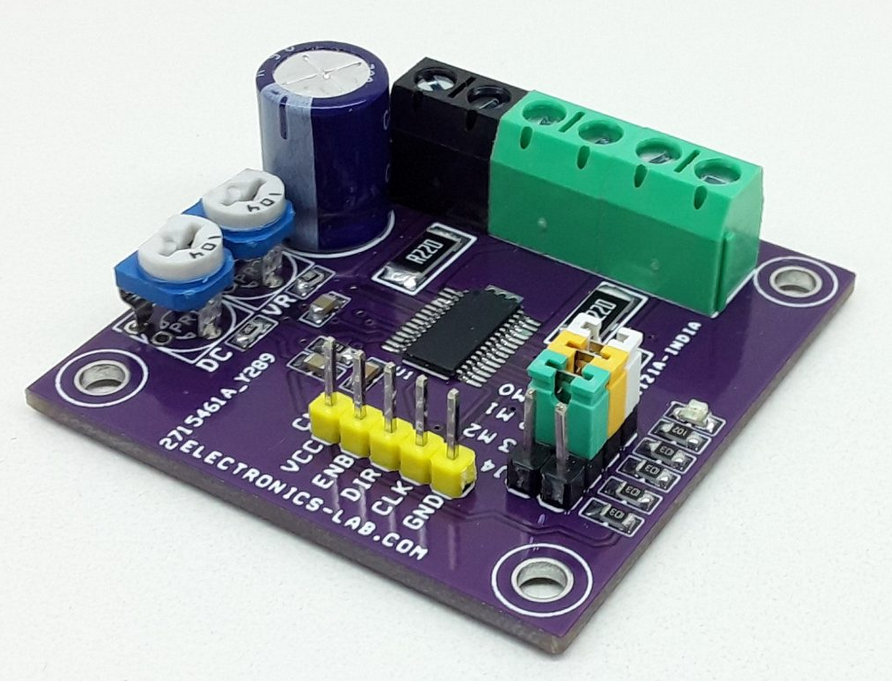

High performance, high reliability bipolar stepper motor driver based on BD63731EFV
The project presented here is a bipolar stepper motor driver. It is based on the BD63731EFV chip, a low-power driver driven by a PWM signal. The project power supply voltage is 8~28V DC, and the rated output current is 3A. The input interface adopts CLK-IN drive mode, and the excitation mode corresponds to FULL STEP mode (2 types), HALF STEP mode (2 types), QUARTER STEP mode (2 types), 1/8 STEP mode, 1/16 STEP mode through the built-in DAC . In terms of current attenuation, the SLOW DECAY/FAST DECAY ratio can be set without any restrictions and all available modes can be controlled in the most suitable way. Additionally, the power supply can be driven by a single system, simplifying design.
参考设计图片
