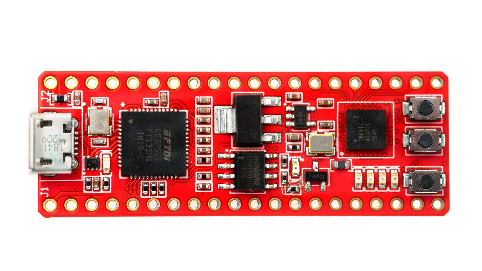

FireAnt is the first third-party development board in the Efinix Trion product family. It provides an easy-to-use development platform for FPGA manufacturers and enthusiasts. Powered by Efinix Trion T8, FireAnt requires only a PC and requires no additional components. Breadboard-friendly design allows applications to be quickly deployed using sensors, peripherals or other interfaces. It is the perfect solution for manufacturers prototyping their projects or for digital design students to quickly learn FPGA development using the new Efinix platform. The power/performance/size advantages of Trion T8 FPGA also make it ideal for edge IoT applications.
Features and specifications
Efinix Trion T8 FPGA
7384 LE Count
8 embedded multipliers
1 low power oscillator
1 phase locked loop
122.88 kbit Internal RAM
Package size: BGA-81 5x5 mm
Board size: 51.4 x 18.3 mm
Supply voltage: VBUS 5 V | VCC 3.3 V
VCCIO: 3.3V
On-board 33.333 MHz crystal oscillator for PLL
GPIO: 35
LEDs: 6 (including 4 user-configurable LEDs)
Flash: 8 Mbit Serial NOR Flash
Programming Interface:
USB 2.0 High Speed (480 Mb/s)
JTAG (pins exposed at the bottom level via external JTAG programmer)
Development Platform: Efinity Software
