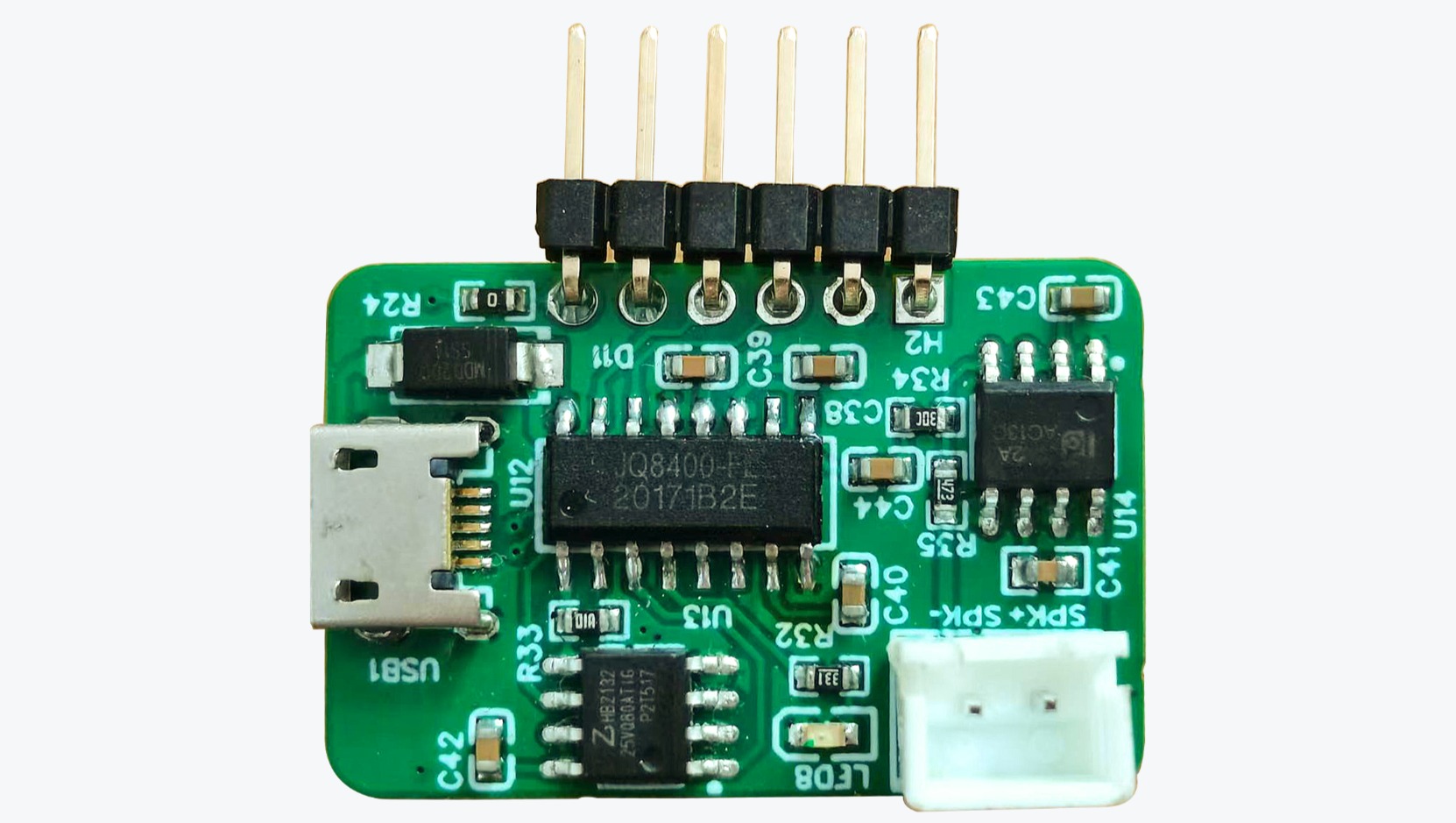

3. Product Overview
1. The power supply is 5V
2. The MICRO-USB interface is reserved, which can be directly connected to the PC to recognize it as a U disk, and you can copy the voice you want into it
. 3. The BUSY signal is reserved during voice playback for judgment. Whether the voice broadcast is over
4. Control the sequence of broadcast voice through the serial port
5. The volume of the voice playback can be set through the serial port command
6. This module is designed for a two-layer PCB board
4. Product parameters
Electrical parameters:
1. Input voltage: 5V
2. Among them, 3.3V The power supply uses the JQ8400-FL voice chip to self-output 3.3V
3. The audio power amplifier uses 8002A, which can drive a 4-ohm 3W speaker at most
. 4. The FLASH part needs to use a minimum capacity of 8Mbit or more, so that the PC can recognize the minimum U disk capacity of 1MByte, voice format is MP3
5. Control input and output signal 3.3V/5V
6. Two-layer board design
mechanical parameters:
PCB size: 30mm long, 20mm wide
