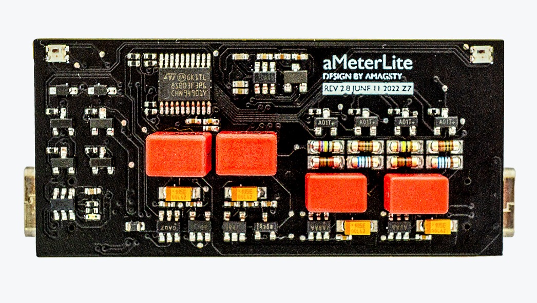

3. Product Overview: An
operational amplifier is used inside the ammeter to amplify the sampling voltage to reduce the internal resistance. Four ranges are set in the schematic diagram, and other range allocations can be achieved by changing the sampling resistor.
Range switching is controlled by STM8. After the sampling voltage exceeds this range, the rising edge of the comparator output is used to generate an interrupt for STM8 to switch to a higher range.
TYPEC on both sides, the left side is input and the right side is output. The two CC lines and D+ D- data lines of the female socket are directly connected and can be used for protocol boosting or jumper connection to USB2.0 devices.
The circuit of this machine is powered by a battery (common ground), and the power input ripple does not affect the accuracy.
It can be used for conventional ammeters by HACKing the TYPEC male connector.

1. Due to the need for packaging, the op amp model in the schematic diagram does not match the actual model. The actual op amp model should be: MAX4239AUT+T (silk screen ABAA). Please pay attention to the corresponding instructions in the schematic diagram.
