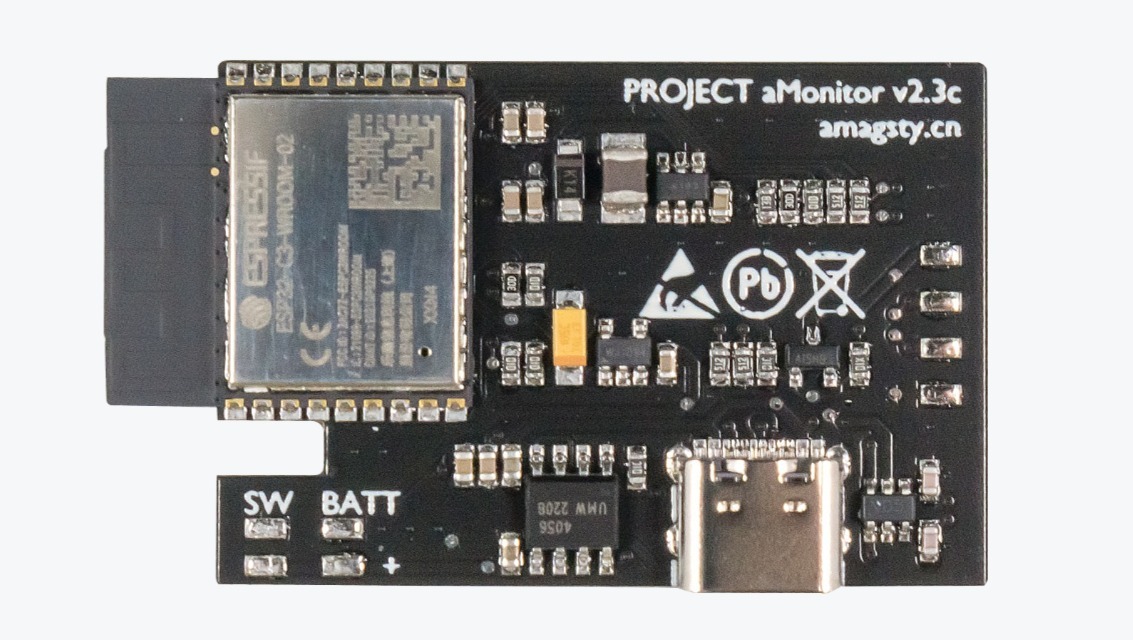

. 3. Product overview:
The development board uses the ESP32 C3 module, which currently has rich information and high cost performance.
There is a 1.12-inch 96x96 resolution OLED onboard, and the UI can be implemented through interface libraries such as LVGL.
Powered by 602030, 300mAh lithium battery. It has a hardware self-locking switch that can completely disconnect the power supply without affecting charging through the TypeC interface.
There is a small translucent window on the panel to facilitate status information display through LED.
There are 2 GPIO, 3.3V and GND on the side, which communicate with the sensor through the magnetic interface. GPIO can be freely configured to implement I2C, single bus and other protocols.
The PCB leads to the USB debugger that comes with the ESP32 C3 module, and 6 regular burning points are reserved as backup.

The hardware part of this solution is divided into 4 parts: PCB, screen, 3D printing shell, and acrylic panel. Please place orders for each part separately.
PCB components can be welded by SMT or your own hot air gun/heating table. The screen needs to be welded to the PCB and bonded to the PCB with double-sided tape. The battery needs to be welded to the PCB and bonded to the bottom case with double-sided tape. Four pins. The pin needs to be soldered to the PCB through wires and fixed to the casing, and the magnet needs to be bonded with liquid glue after being embedded in the casing. The panel needs double-sided tape to be attached to the shell. For specific installation methods, please refer to the attachment: Installation and Usage Tutorial.rar.
The software part requires you to have ESP32 development capabilities and develop your own products according to your needs. It is recommended to use the ESP-IDF platform. Please modify the corresponding GPIO number in your program according to the markings in the schematic diagram.
Due to location restrictions, there is no screen printing of component numbers on the PCB. If manual placement is required, please refer to the attachment: Manual placement reference.zip, which indicates the specific component parameters and can be printed out for ease of placement.
