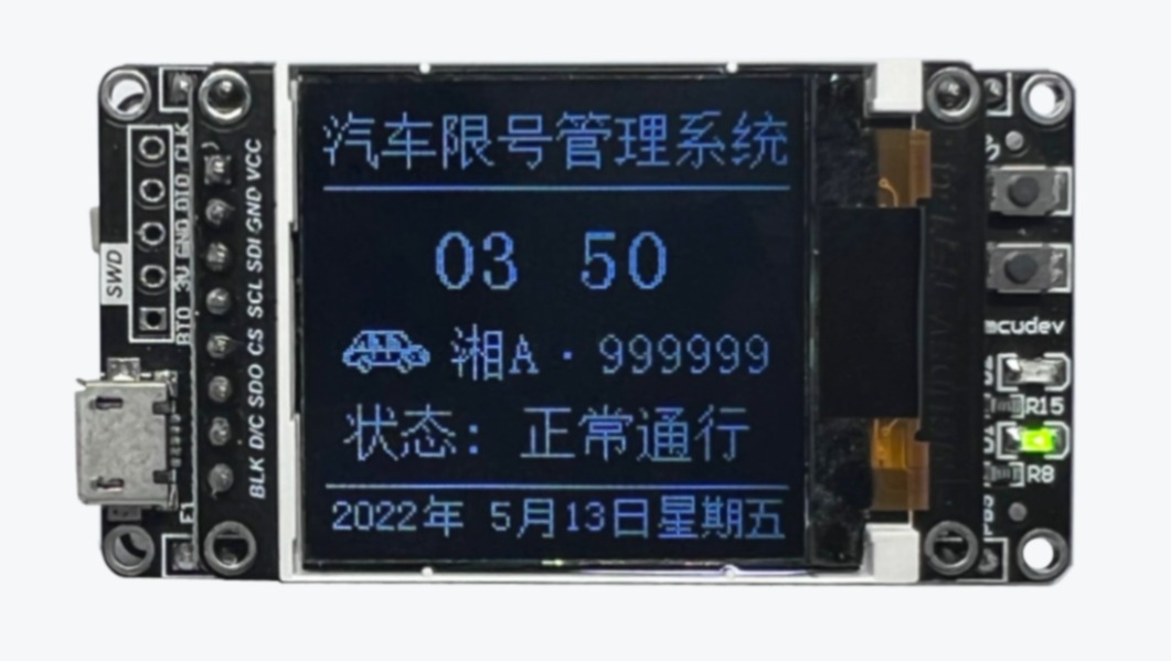

This design is mainly used to implement STM32F103C8T6 + ESP8266 to connect to Alibaba Cloud The Internet of Things platform implements the function of a compact license plate number restriction prompter. You can set license plate information, regional number restriction rules, system real-time date, time and other parameters on the device; the system can based on the set license plate information and regional number restriction rules, Automatically calculate whether the license plate number is restricted on the current date. If the license plate is restricted, the user will be prompted through a buzzer. At the same time, there will also be a pop-up prompt on the mobile APP. The specific effect can be seen in the demonstration video.

1. Powered by Micro USB interface, DC-5V;
2. Use ESP-12F to connect to 2.4G WIFI network;
3. Use 1.44-inch LCD display to display system parameters in real time;
4. Support mobile APP for real-time remote control control, alarm prompts, etc.

2. You can view the real-time time and license plate on the main interface on the LCD. Information, number restriction rules and other parameter information;
3. Use the three function buttons on the mainboard to switch the setting menu to set the number restriction rules, license plate information, and view cloud server parameters;
