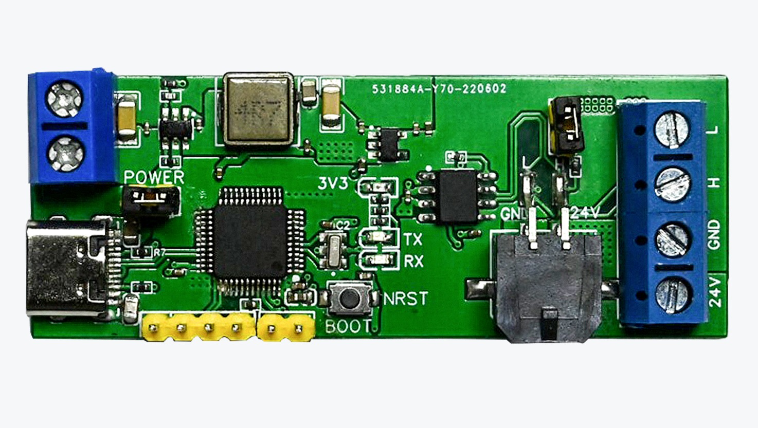

Through this module, the host computer can be connected to the printer control motherboard through CAN to achieve a more stable connection to prevent USB shutdown and loss of connection due to interference and other issues. .

This module is a USB to CAN module developed based on stm32 microcontroller. It uses stm32f072c8t6 or stm32f072cbt6 as the main control. The can transceiver chip is TJA1051T/3. Use As a dcdc chip, jw5026 can choose to use USB power supply or use 24v step-down to power the module through jumpers. The two connectors of the module are connected in series and can be freely selected from two connectors, and are equipped with terminal resistor jumpers. When two connectors are used at the same time, they can provide 2a output capability, and if only one is used, it can provide 5a output. The module has a programming port and a boot jumper for users to program firmware, and firmware can also be programmed via USB.

4. Chip used in the module: Main control: stm32f072c8t6, can transceiver chip: TJA1051 , 24v step-down chip: JW5026, 5v step-down chip: ME6217C33M5G
5. Number of can channels: 1
6. PCB size: 65x25mm four-layer board design single-sided layout
7. Output interface: MX3.0 2X2P connector, 5mm pitch terminal block
8. Equipped with a 120 ohm resistor jumper to flexibly select the terminal resistor

component link in the attachment. 4. This module does not have silk screen position marks for the convenience of layout during proofing. You can refer to the component assembly diagram in the attachment for easy welding.
