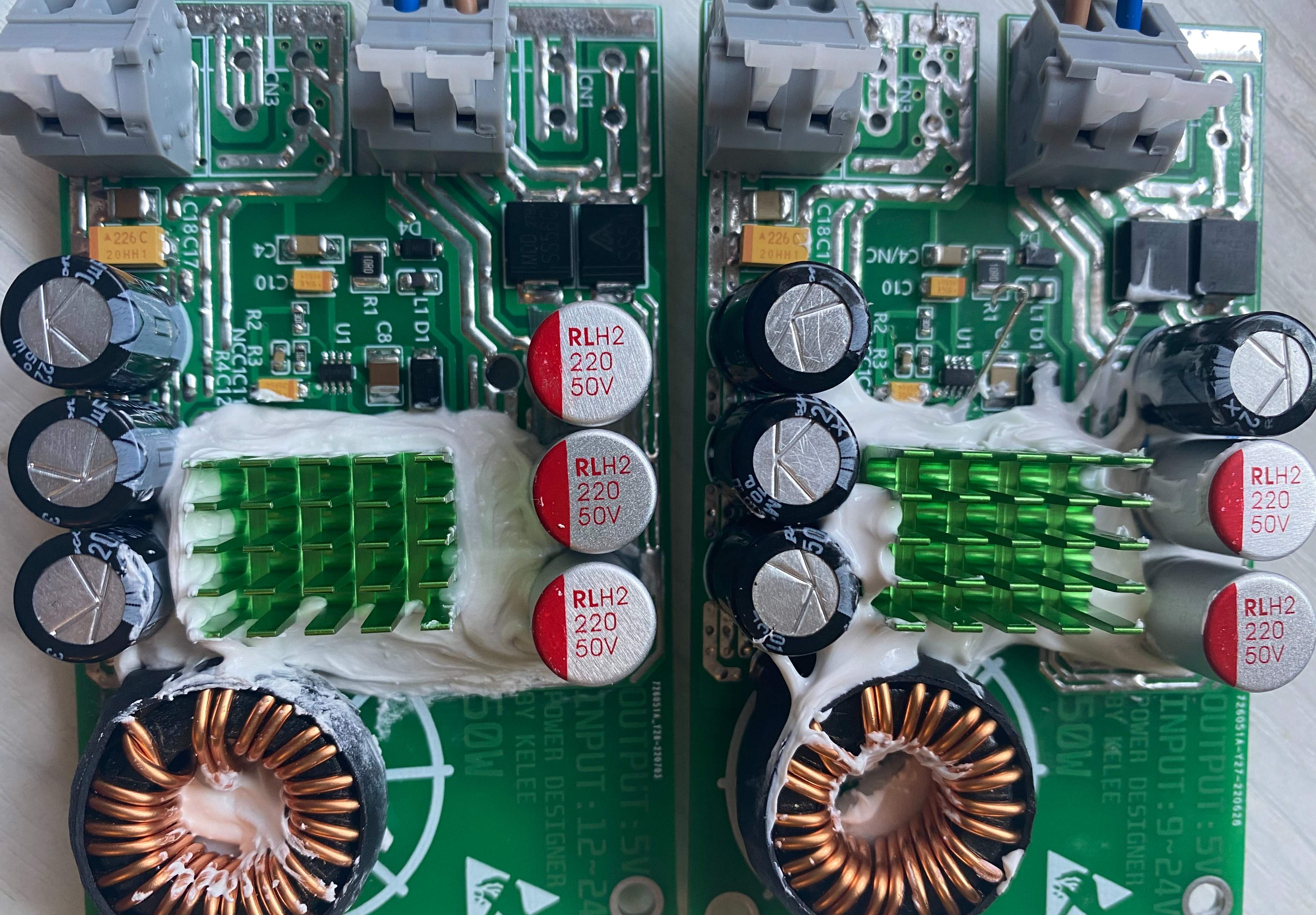

sync buck
Here are some test parameters
input:12V,output:5V5A:
Ripple:<100mV
PSRR:14dB
input:12V,output:5V1A:
Ripple:<60mV
PSRR:10dB
input:12V,output:5V0A:
Ripple:<60mV
PSRR:-4dB
input:18V,output:5V2A:
Ripple:<70mV
PSRR:16dB
 (too much)
Inductor and capacitor selection reference datesheet
The mos tube should have low Rson and low Vgs. It is best to use the tubes indicated on the datesheet for synchronous rectification.
I refer to this person for peripheral circuits , thank you
Project files on GitHub
