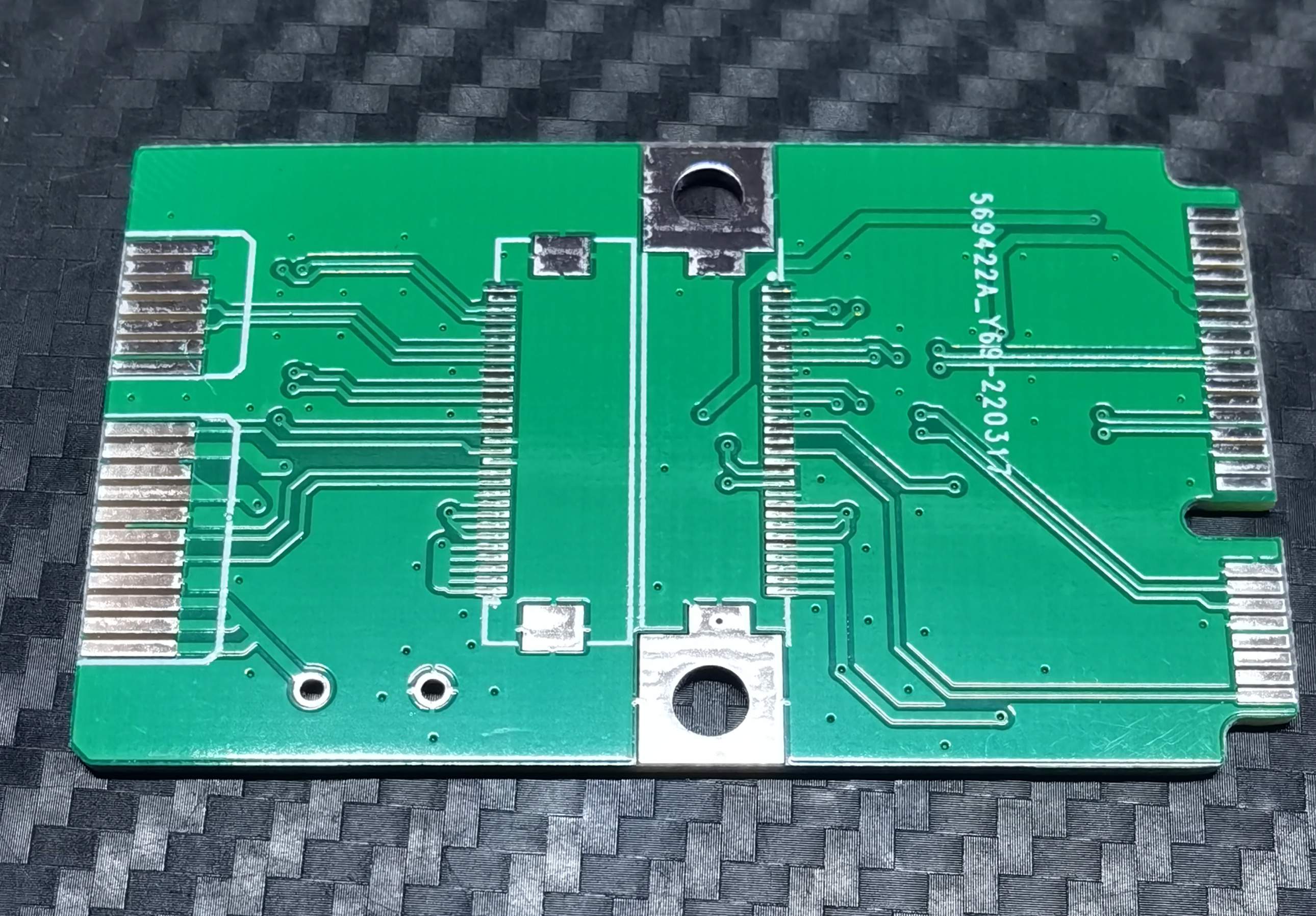

This is a minipcie to PCie adapter board. It can transfer the minipcie interface on the motherboard to a standard PCie interface. Since the minipcie only has x1 bandwidth, it can only be transferred to a PCie with x1 bandwidth. It is good to plug in a network card. of.
I tested it and it works.
The picture above shows my 2955U small host connected to an 82576 dual-port network card.
All you need to do is cut this board in the middle, connect it with 30p0.5mm co-directional cables, and solder a PCIe slot on the plywood.
The slot length is arbitrary, and the valid pins are only x1 length.
Note: minipcie does not provide +12V power supply, so this adapter board does not have +12V power supply.
If you need +12V power supply, just connect +12V to the reserved pad.
Summary of required materials:
1. One piece of my PCB.
2. Two 30p0.5mmFPC sockets.
3. A 30p0.5mm FPC connection cable in the same direction, of any length.
4. Plywood pcie slot, any length
Apology: The capacity is limited and the differential line wiring needs to be improved.
Notice! ! ! ! ! ! ! ! ! ! The board thickness should be 1.0mm, and the minipcie must be 1.0mm.
