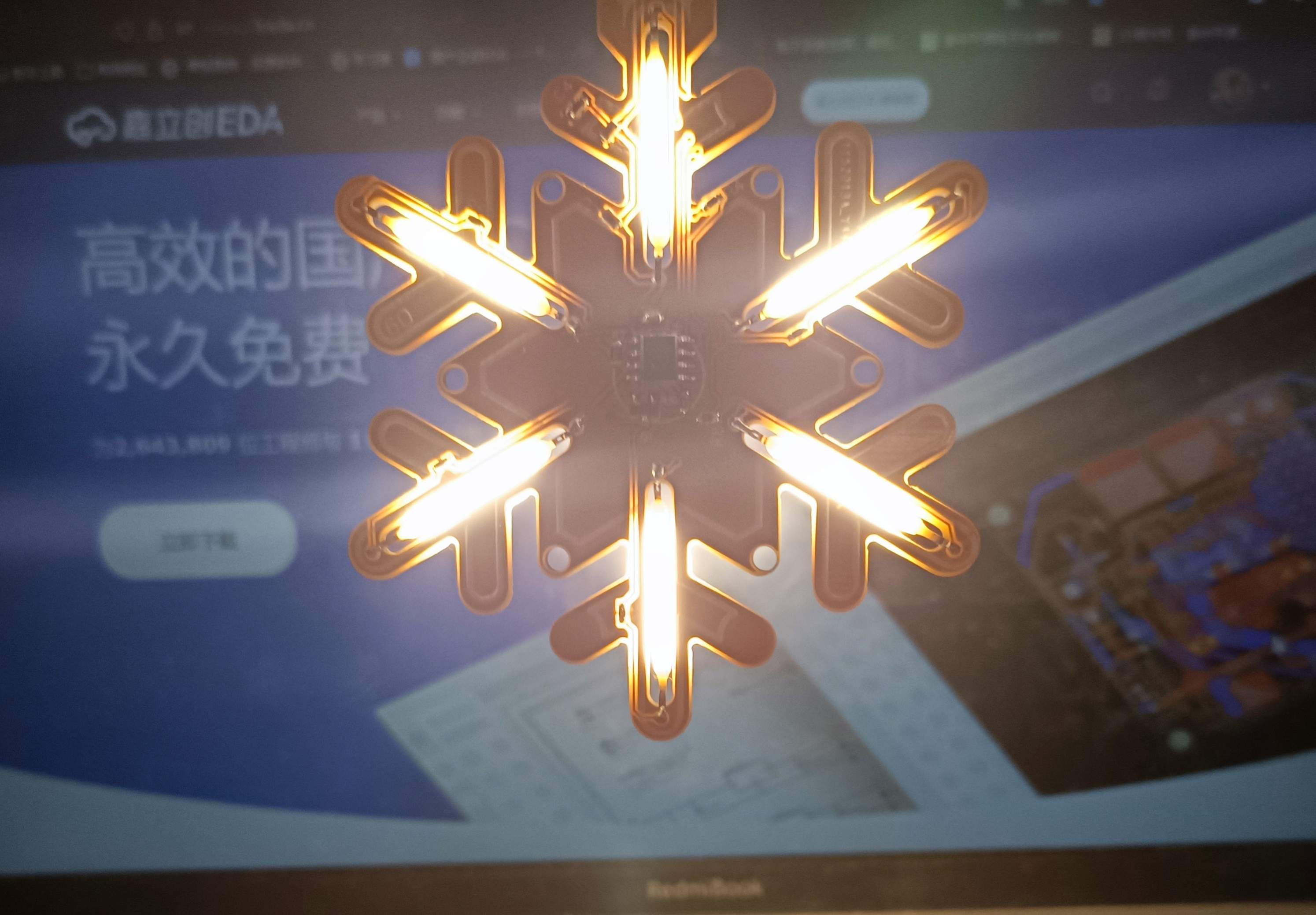

This open source is modified from https://oshwhub.com/mondraker/snow_light (Thanks to the boss mondraker!!!). I added two DIP switches to realize the four modes of SGL8022W. Just switch the two DIP switches. To realize the mode conversion (the realization of the function requires re-powering the chip and making an additional switch), the slot in the middle part of the PCB is omitted. (I am a novice, so I would like some advice from the experts). The following are four modes
