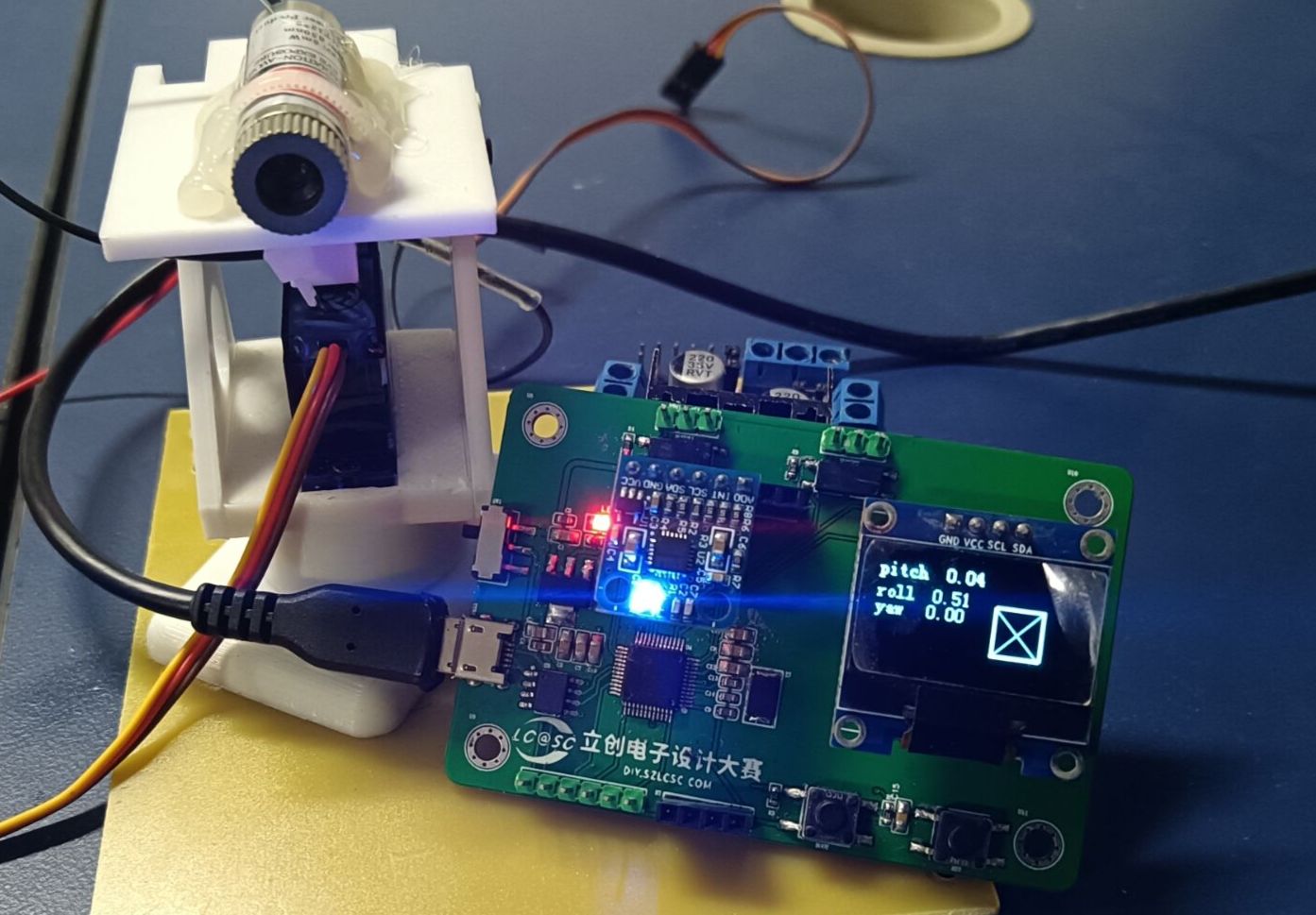

This project uses the N32G430 series produced by National Technology as the main control, and the data acquisition module uses the MPU6050 six-axis acceleration sensor module to obtain attitude information. It is widely used in flight control, balance car and other fields. It can be seen that it has very powerful functions and is deeply loved by every electronic person. The control module uses a two-dimensional pan-tilt, which is a module that every college student majoring in electronics often comes into contact with. It includes many fields such as motion posture analysis and steering gear motion control. This project combines the two-dimensional pan-tilt and the MPU6050 module to see what kind of sparks they can create.

Because the MPU6050 module I used is the official one of Zhengdian Atom, its SDA and SCL pins are opposite to those of the MPU6050 module used by the training camp, so I modified the code and swapped the original SDA and SCL, and finally successfully drove the official MPU6050 of Zhengdian Atom. Later, because I added a two-dimensional pan-tilt control, the main control chip needs to generate PWM to drive. So I found in the official data manual that timer 2 can be used to generate two PWMs to control the two servos of the two-dimensional pan-tilt separately. They are PA1 of channel 2 and PA2 of channel 3, as shown in the figure below:
moQFDTIkUdIeVG3PdTVMeVDvIdj8Ud6k5ZCMdZhS.pngServo description:
This two-dimensional pan-tilt is equipped with two SG90 servos. This servo is relatively cheap and is the best choice for beginners to get started with servos.
KavegvRsro9tenRnVEczaLbmJ25QiTWqGHBjepZs.pngThe control of the servo requires the MCU to generate a pulse signal with a period of 20ms, and control the rotation angle of the servo with a high level of 0.5ms to 2.5ms. *6. Please enter the content of
