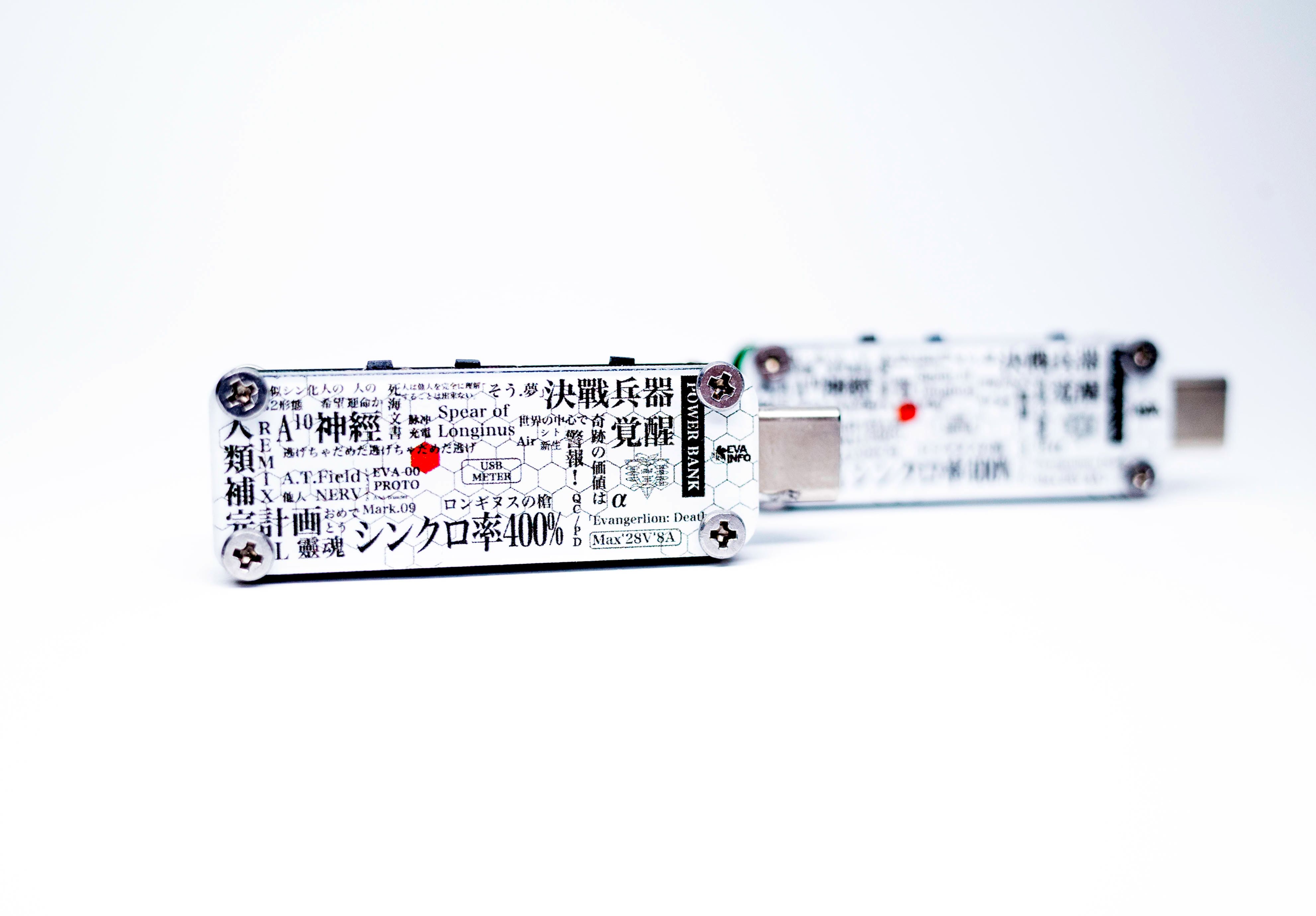

USB current voltage meter board
1. This panel is only suitable for https://oshwhub.com/qaxslk/dai-PD-QCyou-pian-jian-ce-yi-ji-#P4  . If you need to print other pages, please modify the source file yourself.
