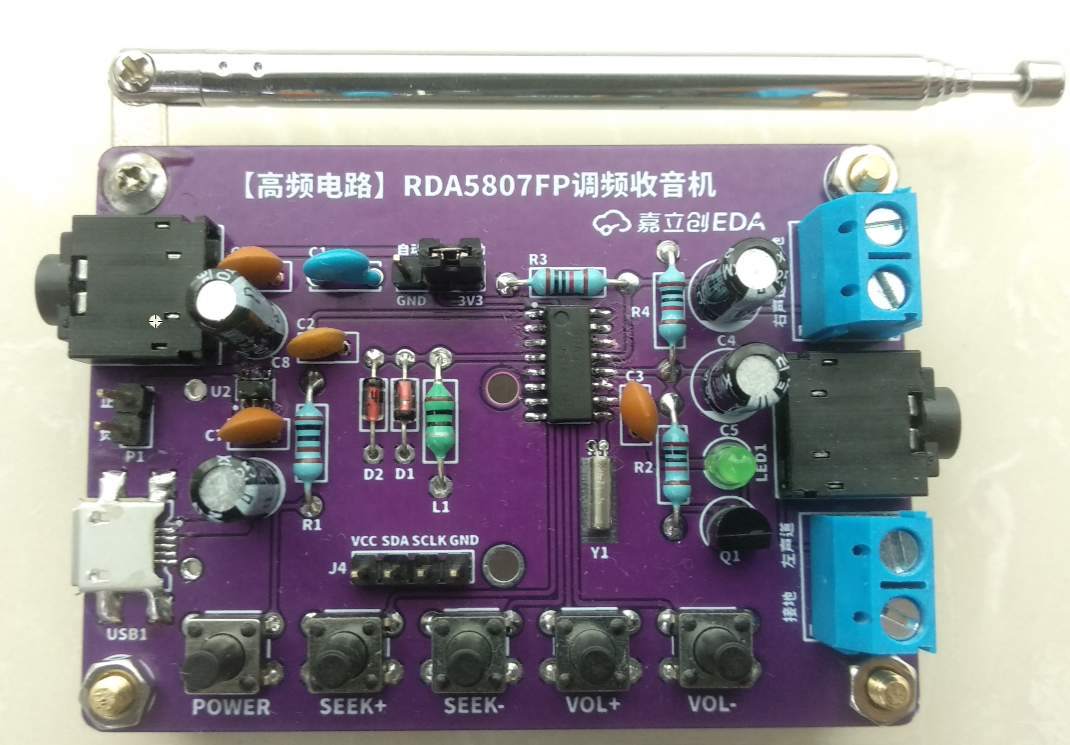

FM radio can be divided into three major modules: power input circuit, FM radio circuit and external audio output circuit. The circuit principles of each module will be analyzed below.
The power supply part mainly uses the Micro USB female socket as the power input port, C6/C7 as the power filter capacitor, 5V is then stepped down by a linear regulator to output 3.3V , which supplies power to the radio circuit, and C8/C9 is the stepped down filter capacitor ; You can also use the pin header to connect to an external 3.3V power supply .
Figure 3-1 Power input circuit
The U1 wireless transceiver chip uses RDA5807FP to convert high-frequency signals into audio signals. Using the H1 rod antenna, J2 can use a headphone cable or a 3.5mm audio rod antenna as an antenna to receive signals . You can use a jumper cap to short pin J3 to switch the radio mode. Short-circuited to the power supply ( 1/2 short-circuited), the radio is in manual mode, you can switch channels through the SEEK+/SEEK- electric tuning button, short-circuited to ground ( 2/3 short-circuited), the radio is in automatic mode, write a program The radio is controlled through the I2C bus .
Figure 3-2 FM radio circuit

When welding, you should first weld the chip components, then the plug-in components, and follow the principle of welding from low to high. Novices can refer to the welding sequence: USB/LDO/RDA5807 → Crystal Oscillator / Diode → Resistor / Inductor → Capacitor / LED / Transistor → Row Pin / button→audio interface / terminal block.
When welding, be careful not to have false soldering, missed soldering, or wrong soldering. For devices with polarity such as capacitors and diodes, you need to pay attention to the welding direction. All devices must be aligned and flat to avoid unevenness.
When welding, the temperature must be controlled, and the temperature should not be too high. Too high a temperature can easily cause the device to burn out; the tin point should not be too large, as it can easily cause the device to be welded and have poor contact; do not use too much force, as too much force can easily cause the board to break or short circuit. The solder mask paint peels off, etc.
Figure 6-1 PCB assembly diagram
Figure 6-2 Unsoldered PCB board
After the welding is completed, check the circuit for short circuits, open circuits, false soldering, etc. Only after the inspection is correct can you turn on the power. When using pin headers to connect external power supplies, you should pay attention to the positive and negative polarity of the power supply, and do not connect it reversely.
Use a jumper cap to short-circuit J3 in manual mode. If you do not short-circuit J3 , you will not receive sound. Plug in the earphones to hear the rustling sound. Pull out the antenna and press SEEK+/SEEK- to receive the FM station. You can receive five to six A station.
