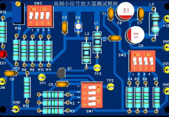

Practice Project 2 High Frequency Small Signal Amplifier Test Circuit
        In the production of a typical single-stage high-frequency small-signal amplifier, color-coded inductors or I-shaped inductors can be sampled when the frequency is below 30MHz. In this design, the input side of the loop uses an inductor tap, while the output side uses a capacitor tap. It is very flexible to set the access coefficient. .
        DIP switches are connected in parallel at both ends of the loop to connect different loss resistors and change the quality factor of the loop. This allows us to intuitively appreciate the impact of the quality factor on the technical parameters of high-frequency small signal amplifiers.
        The transistor emitter uses a DIP switch to connect different emitter resistors, or the emitter resistor is bypassed with a capacitor to experience the impact of the emitter current on the technical parameters of the high-frequency small signal amplifier.
        The output end of the amplifier is connected to different load resistors using a dip switch, or it is open-circuit output to experience the impact of different loads on the technical parameters of high-frequency small signal amplifiers.
        The module power supply uses a choke coil to implement LC filtering to filter out power supply ripples, and the onboard LED serves as a power-on indicator light.
The overall schematic diagram of the circuit is as follows:
        The module PCB design uses top-layer wiring and bottom-layer copper laying to further improve high-frequency characteristics. The module PCB is shown in the figure below.
        The module is set with input terminals, output terminals and test terminals. UIN is connected to an external signal source (signal generator) to GND for signal input, +12V is connected to GND to an external +12V DC power supply, and UOUT is connected to an oscilloscope and other test equipment to GND as the output end. TP1, TP2 and TP3 are the test points of the transistor base, emitter, and collector respectively. The module layout is shown in the figure below.
