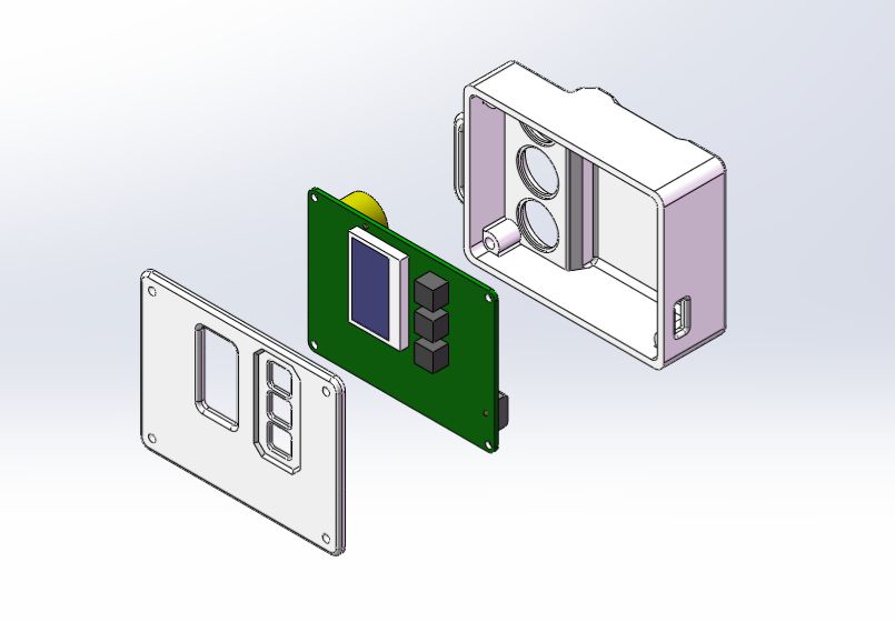

DIY a small portable flashlight, lithium battery, with OLED display, convenient display of brightness level, remaining power, remaining time, no more power anxiety.
Designed with a magic buckle handle, it can be easily hung on the backpack strap or belt, convenient lighting, freeing hands, it can be said to be a great tool for walking the dog and shoveling shit.
(1) The MCU uses the National Technology N32G430C8L7, which is cheap and powerful.
(2) The flashlight has 5 gears: moonlight, low brightness, medium brightness, high brightness, and extreme. The brightness of each gear can be set separately.
(3) The flashlight is designed with a fuel gauge function to display the battery charge and discharge current and battery capacity, and estimate the remaining usage time.
(4) The shell was painted, and it was the first time to try 3D printing. The resin shell was printed on 3D Monkey, and the effect was good.

The 3D printed shell can hold a battery of up to 30*40*10mm, taking into account the space for the wires.
The battery can hold up to 1500mAh, the current of the ultra-bright mode is about 1.2A, and the battery life is at least 1 hour. However, since the working temperature of the 3D shell (resin) cannot be too high,
the ultra-bright mode (500lm) can only work for about 3 minutes at a time, and it will overheat and downgrade. The high-bright mode (200lm) can be always on, and the brightness of the gear can be set freely.
(Postscript, the room temperature is 36 degrees, the shell is installed, and the ultra-bright mode will downgrade after 1 minute) If conditions permit, you can print a nylon shell, which can withstand high temperatures. The downgrade temperature can be higher.
The LED lens I bought is 13*7mm acrylic, with a variety of divergence angles to choose from. Here I use a 10-degree smooth surface and two 30-degree beaded surfaces. TB is very cheap, 70 cents per piece.
The smaller the lens angle, the more focused it is, and vice versa.
OLED can be changed to a universal one by yourself, and the PCB size is reserved.
Don't ask, this screen is in stock.
