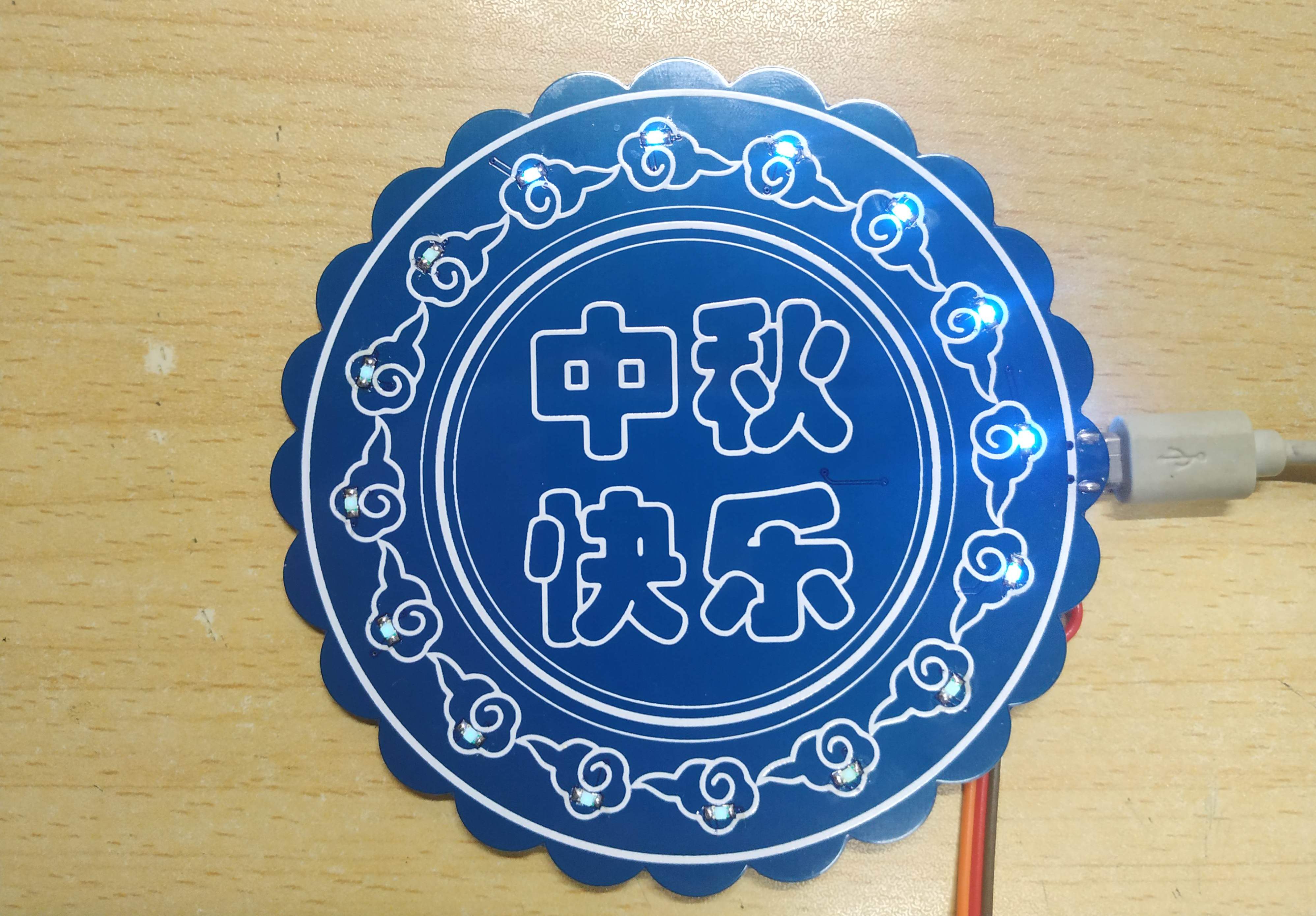

Mid-Autumn Festival Mooncake Wireless Powered Flowing Light, use STC8G1K08A to control the running water lamp composed of 16 LEDs. The LEDs are placed inside the auspicious clouds. Let’s call them running cloud lights for the time being, hahaha. There is a problem with the wireless charging function. The copper sheet will be inductively heated, causing the efficiency to drop sharply, so this function has been abandoned. There is no reserved burning port and requires flying wires. The IO port is configured in high impedance and push-pull mode to illuminate each LED individually. Program files will be uploaded later
