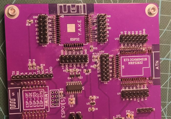

nrf52832_esp32_8266_12F burner_v1
A by-product of playing nrf52382, I made both esp32 and esp8266 by the way.
Unexpectedly, the board that was frequently replaced in the end was actually CH554. I bought a lot of fakes.
Don’t search directly for test pins with half-hole test pins, they are expensive as hell.
Search the test site, there will be 1,000 pieces for 44 yuan, buy it and bend it yourself.
The xc6206 used for 3v3 voltage stabilization has a weak current carrying capacity. If necessary, replace it by yourself.
