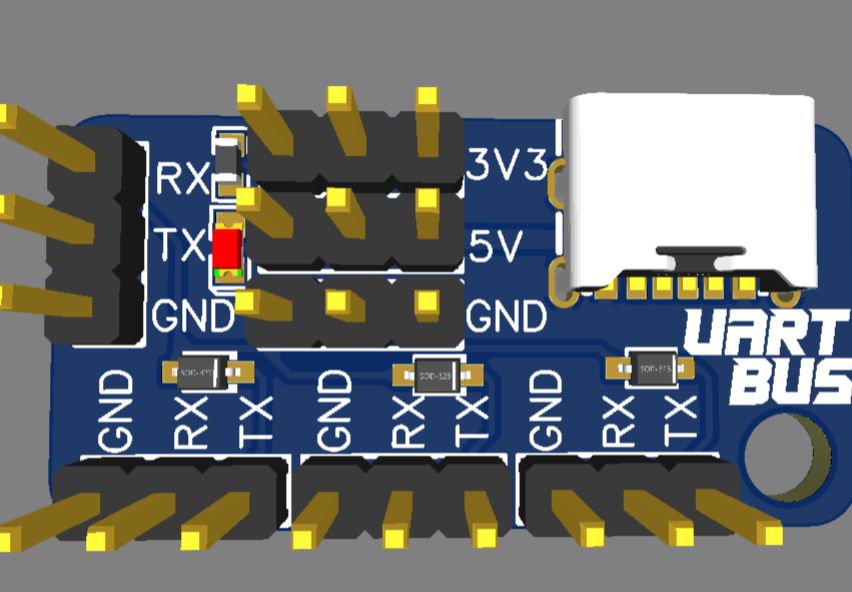

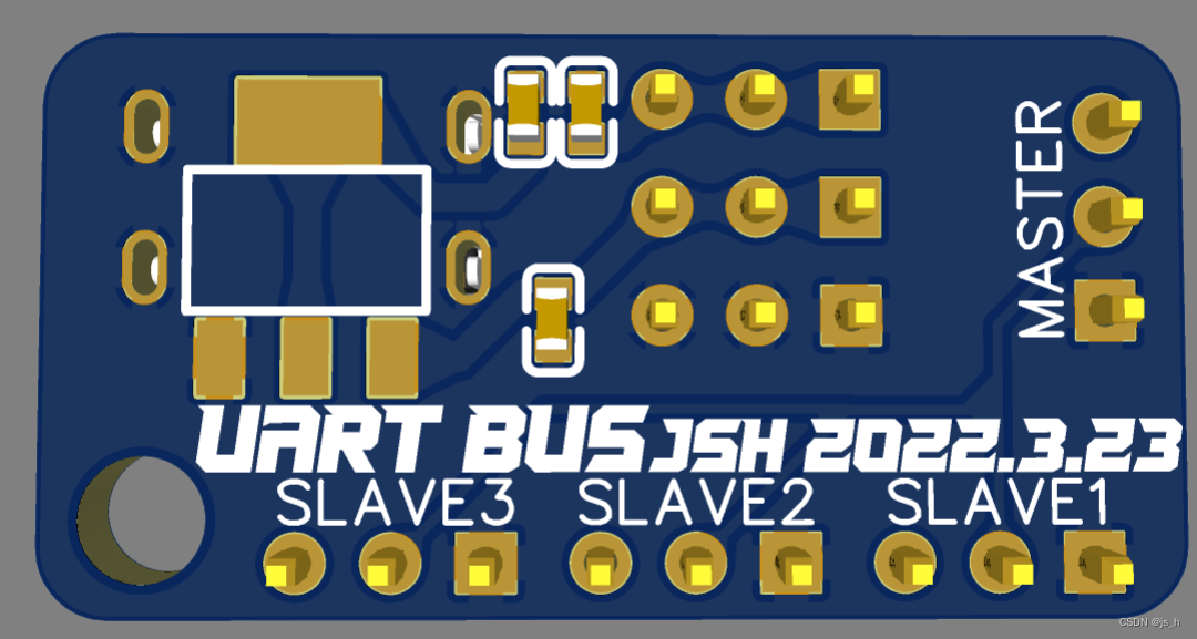

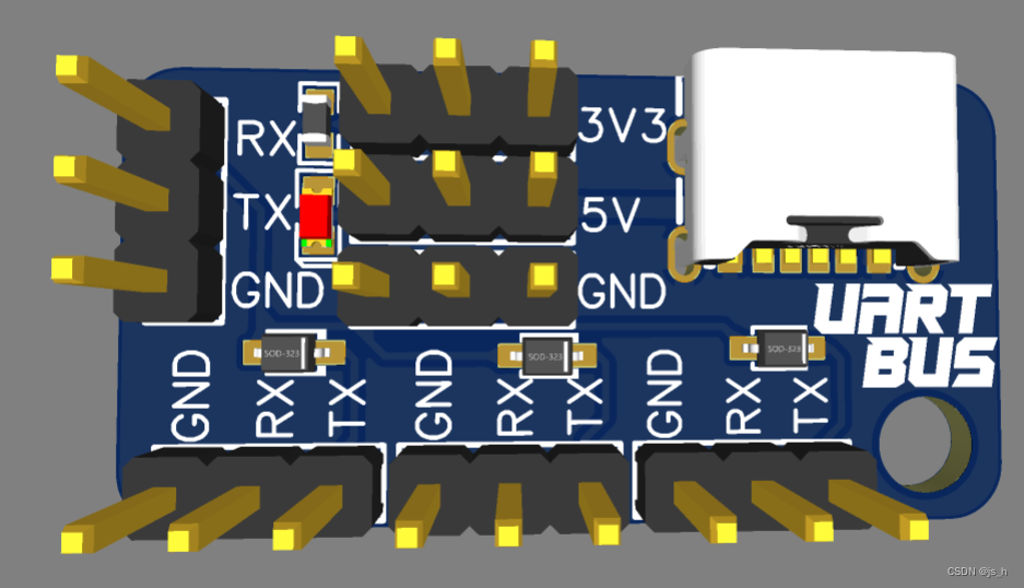

Verification scheme is feasible. Type-c does not affect the use of the serial bus if it is not connected to the power supply. When the type-c is connected to the power supply, it can lead to 5v and 3.3v interfaces to supply power to the module. The board is simple, as long as you know the principle, you can use it in your own projects.

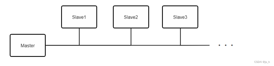

When the UART interface of the microcontroller we use is insufficient, we can use UART to implement a bus-type one-master-multi-slave communication structure, as shown in the figure.
Figure 1 UART bus type communication structure

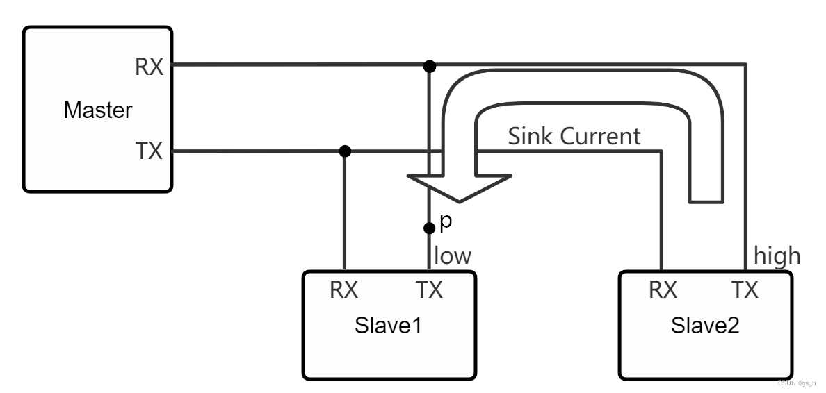

If you connect the slave's TX directly to the master's RX, then the TX pins between the slaves are connected together, as shown in Figure 2. When Slave1 tries to send information to the Master, since the UART starts with a low level, the TX pin of Slave1 is low level, while the TX pin of Slave2 is high level. At this time, the current flows from the TX pin of Slave2 to the TX pin of Slave1, and the current sink of the TX pin of Slave1 increases. Due to the internal resistance of the device, the increase in current causes the node p voltage to increase, and finally we see that the TX pin level of Slave1 increases.
Because the pin level rises, the RX end of the Master cannot receive the low level from the TX end of Slave1, and the serial communication cannot start.
Figure 2 Sinking current causes the pin level to rise

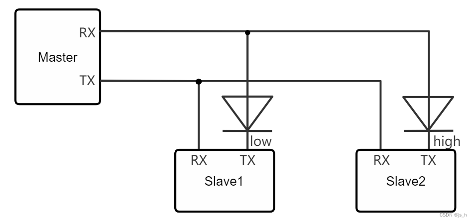

Figure 3 shows another solution where the slave's TX pin is connected to the cathode of a diode and the diode anode is connected to the master's RX pin. Due to the unidirectional conductivity of the diode, the sink current will be limited to a very small range, which is equivalent to an open circuit, thereby avoiding the problem of the pin's low level rising. Since the RX pin of the host is in a pull-up input state, the high-level sampling will not be affected when the diode is turned off.
Figure 3 Using diodes to limit sink current
In fact, according to the principle, N+1 slaves only need N diodes. This is left to you to verify.
